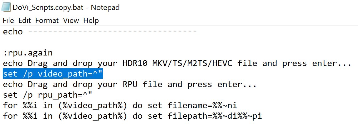

@RESET_9999
Have you tried adding ^" to set /p in your script?
I just injected an RPU, "RPU.(2020)" into a video, "video.(2020)\video.(2020).mkv" with this edit of your script, and it seems to work.
set p fix.png (34.51 KiB) Viewed 16365 times
