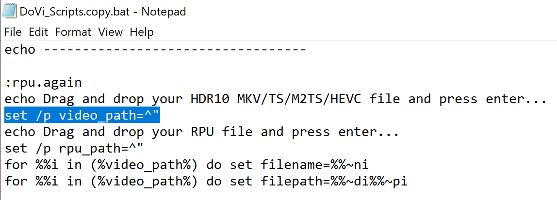

Have you tried adding ^" to set /p in your script?
I just injected an RPU, "RPU.(2020)" into a video, "video.(2020)\video.(2020).mkv" with this edit of your script, and it seems to work.
set p fix.png (34.51 KiB) Viewed 15909 times

Gatorman wrote:
Thu Apr 07, 2022 11:40 pm
@RESET_9999
I updated the scripts, input with special characters/ no space should work now. Thanks!
