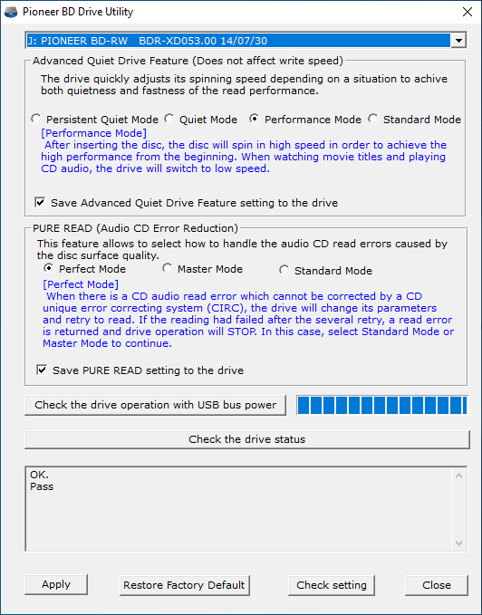

Everything is working well with my drive, I can rip blu-rays and burn disc, everything. But even "Pioneer BD Drive utility" do not see my drive. Do you want to try to solve this issue? Do you want me to help you somehow? Maybe also other people have similar issues using different USB-SATA adapters.
