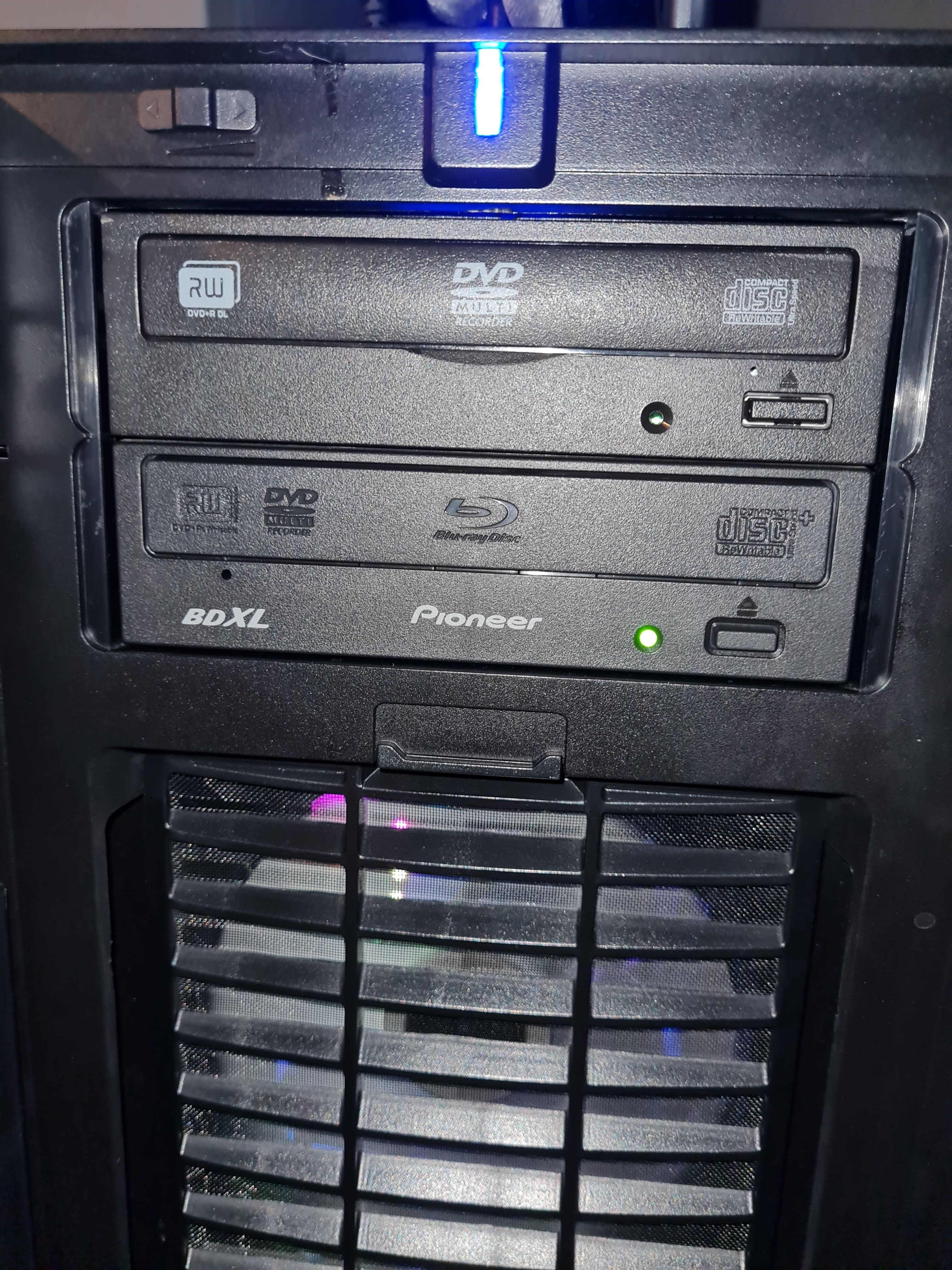

Mine supports BD-XL but wont read UHD discs.mike admin wrote: Sun Feb 13, 2022 1:14 pmWhile the answer to your question is still no, generally this is an open question.bitspain1980 wrote: Sun Feb 13, 2022 12:13 pmUnderstood! I found too much information about it, As it is an ASUS brand recorder I thought I could, but the recorder is really a pioneer... thanks for the info!Billycar11 wrote: Sun Feb 13, 2022 12:08 pm no it wont do UHD if it does not already see UHD discs it not like the LGs were there are friendly and official pioneer drive will only do UHD if they are official.

If you put in a UHD disc it just tries to read for awhile before it gives up and shows no disc.
- 20220214_172943-min.jpg (1.37 MiB) Viewed 86958 times

Interesting... Another reason to research the cross-flash ability...
Just remember, "BDXL" does not necessarily mean "UHD capable". My 2014 BDXL drive can't see a UHD, because it doesn't read at a high enough bit density.
How old is the drive?
I bought the drive a few years ago but not sure when these drives were first available.Woodstock wrote: Mon Feb 14, 2022 6:31 pm Just remember, "BDXL" does not necessarily mean "UHD capable". My 2014 BDXL drive can't see a UHD, because it doesn't read at a high enough bit density.
Please post a picture of your Makemkv information.
I only have a dual layer 209 - so I can't be "brave" anyway. Mike is really good at such things. So I suggest to wait for his cross-flashing recommendations or patched firmwares.Blackened2687 wrote: Sun Feb 13, 2022 3:13 pmWell, if you really want to try, I can provide you such a tool right now. The crossflash on BDR-207 and newer drives was not yet tested (well, technically, it was, but only with a BDR-207 -> BDR-PR1M crossflash, which was a failure - the drive stuck in boot mode with new kernel). I'm now looking for a brave person with a BDR-208 or a newer drive who could test the crossflash for me.Billycar11 wrote: Sun Feb 13, 2022 2:09 pm I would be willing to try if we can find one email me a link if you know of one.
