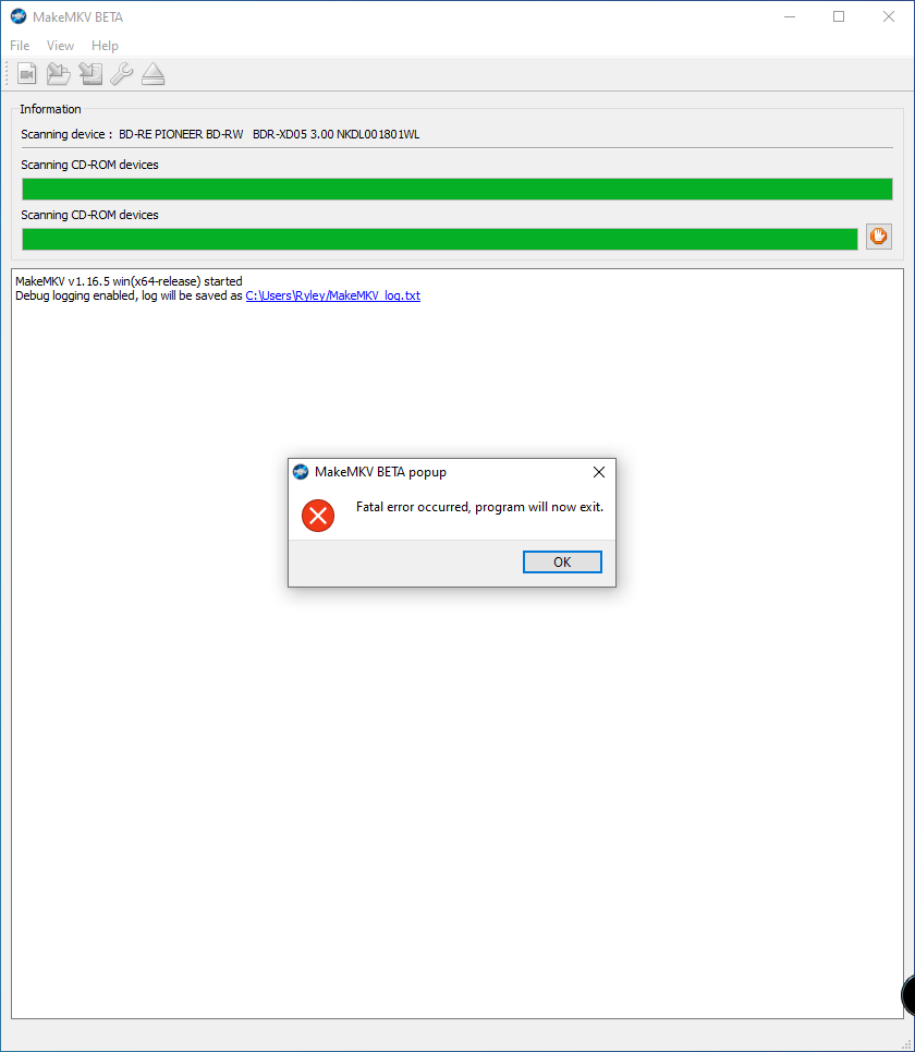

As of SDF v083, my Pioneer BDR-XD05 (3.00) is now LibreDrive compatible. Unfortunately I'm not having much luck with it. If a standard Blu-ray disc is inserted when starting MakeMKV, a fatal error occurs (screenshot attached). Loading a disc after starting MakeMKV also fails but no fatal error message is shown. I've attached the debug log files for both scenarios. (The 'STATUS_DEVICE_NOT_CONNECTED' message was only logged after I unplugged the USB cable)
Edit: I've tested MakeMKV v1.16.5 with SDF v07e again. The same drive/disc combination worked correctly with this configuration, but I can't seem to attach the log file.
- MakeMKV_log - Loading Disc After MakeMKV Startup.txt
- (623 Bytes) Downloaded 2415 times
- MakeMKV_log - Disc Inserted Before MakeMKV Startup.txt
- (5.99 KiB) Downloaded 2128 times
- Posts: 6196
get the pioneer utility and run the power check sounds like your dive is not getting enough power.ryley wrote: Mon Feb 14, 2022 12:44 am As of SDF v083, my Pioneer BDR-XD05 (3.00) is now LibreDrive compatible. Unfortunately I'm not having much luck with it. If a standard Blu-ray disc is inserted when starting MakeMKV, a fatal error occurs (screenshot attached). Loading a disc after starting MakeMKV also fails but no fatal error message is shown. I've attached the debug log files for both scenarios. (The 'STATUS_DEVICE_NOT_CONNECTED' message was only logged after I unplugged the USB cable)

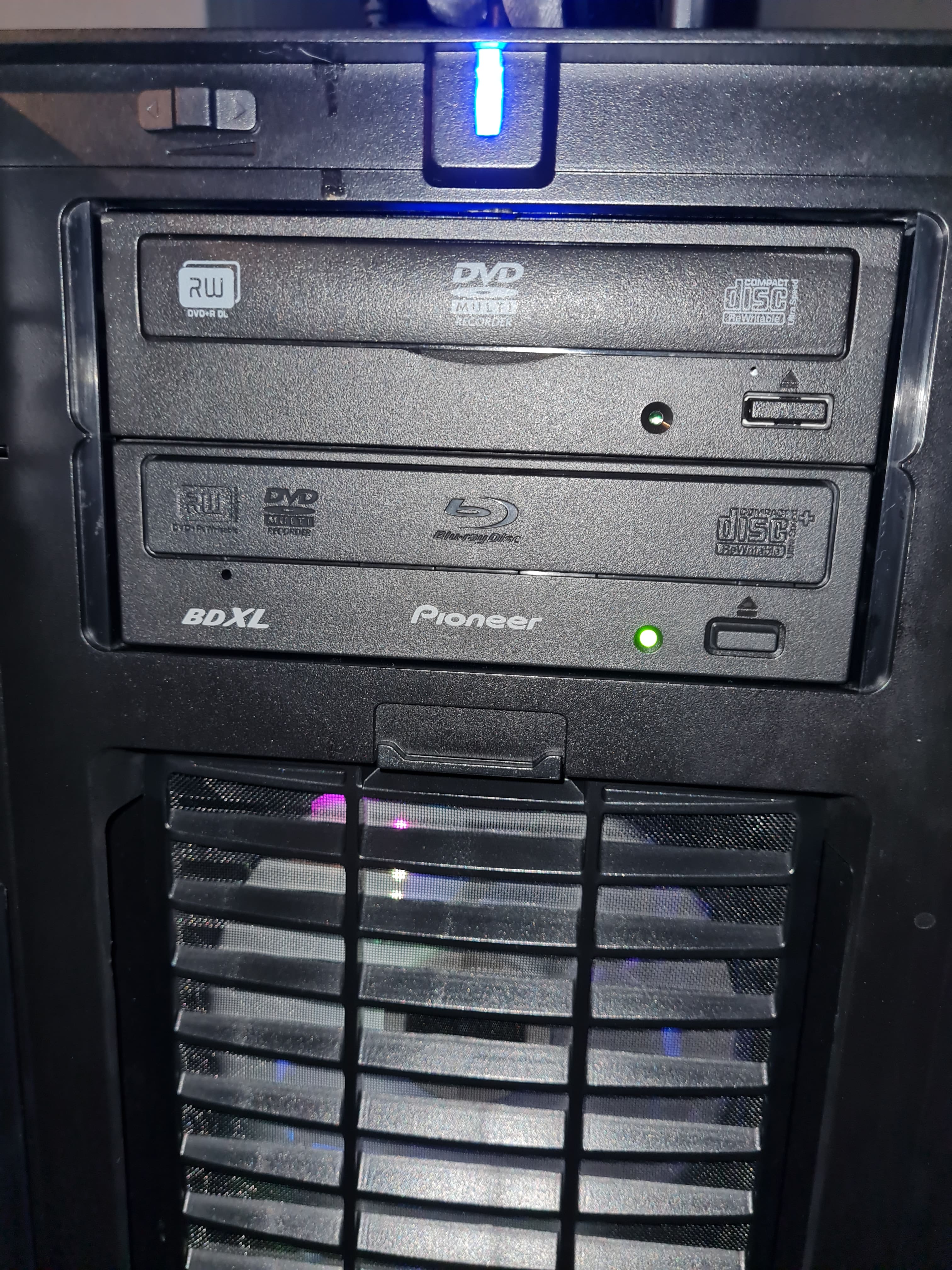

Mine supports BD-XL but wont read UHD discs.mike admin wrote: Sun Feb 13, 2022 1:14 pmWhile the answer to your question is still no, generally this is an open question.bitspain1980 wrote: Sun Feb 13, 2022 12:13 pmUnderstood! I found too much information about it, As it is an ASUS brand recorder I thought I could, but the recorder is really a pioneer... thanks for the info!Billycar11 wrote: Sun Feb 13, 2022 12:08 pm no it wont do UHD if it does not already see UHD discs it not like the LGs were there are friendly and official pioneer drive will only do UHD if they are official.
RS8800 is a first hardware supporting UHD media.
Are there any drives built on 8800+ hardware that do not read UHD? Yes, at least we know one model - Asus BW16D1H-E115 that uses 8F00 hardware, although no Pioneer drive on 8F0x hardware is an UHD drive.
Can we cross-flash the drives on the same hardware platform - technically absolutely yes, but we don't have a production-ready tool for that yet.
So, if we find a Pioneer drive that can technically read UHD, but this functionality is disabled in firmware, would it read UHD if cross flashed (line NS40->NS60 for LG)? We don't know yet.
Generally, I'm very curious if anyone knows about Pioneer drives that can read BD-XL but can't read UHD media. If they do exist, that would sound like a new businesses plan for Billy and Marty
p.s. Your Asus is RS8601, so - no, as far as I know.
If you put in a UHD disc it just tries to read for awhile before it gives up and shows no disc.
- 20220214_172943-min.jpg (1.37 MiB) Viewed 87810 times

- Posts: 10973
Just remember, "BDXL" does not necessarily mean "UHD capable". My 2014 BDXL drive can't see a UHD, because it doesn't read at a high enough bit density.
How old is the drive?
andrewtjb
- Posts: 5
- Joined: Sun Feb 13, 2022 12:00 pm
I bought the drive a few years ago but not sure when these drives were first available.Woodstock wrote: Mon Feb 14, 2022 6:31 pm Just remember, "BDXL" does not necessarily mean "UHD capable". My 2014 BDXL drive can't see a UHD, because it doesn't read at a high enough bit density.
