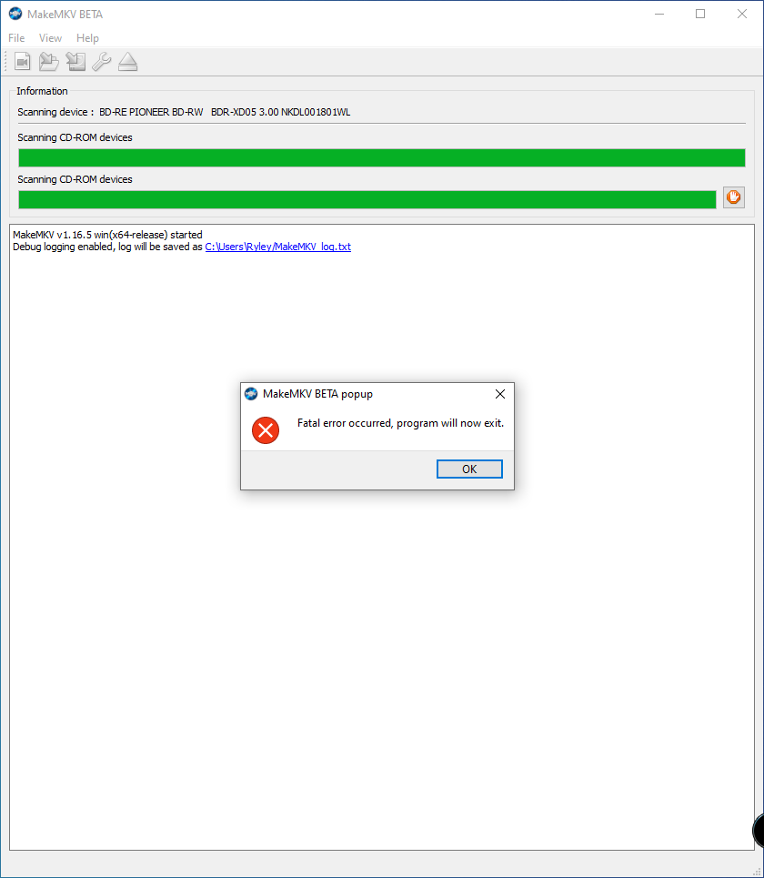

As of SDF v083, my Pioneer BDR-XD05 (3.00) is now LibreDrive compatible. Unfortunately I'm not having much luck with it. If a standard Blu-ray disc is inserted when starting MakeMKV, a fatal error occurs (screenshot attached). Loading a disc after starting MakeMKV also fails but no fatal error message is shown. I've attached the debug log files for both scenarios. (The 'STATUS_DEVICE_NOT_CONNECTED' message was only logged after I unplugged the USB cable)
Edit: I've tested MakeMKV v1.16.5 with SDF v07e again. The same drive/disc combination worked correctly with this configuration, but I can't seem to attach the log file.

get the pioneer utility and run the power check sounds like your dive is not getting enough power.

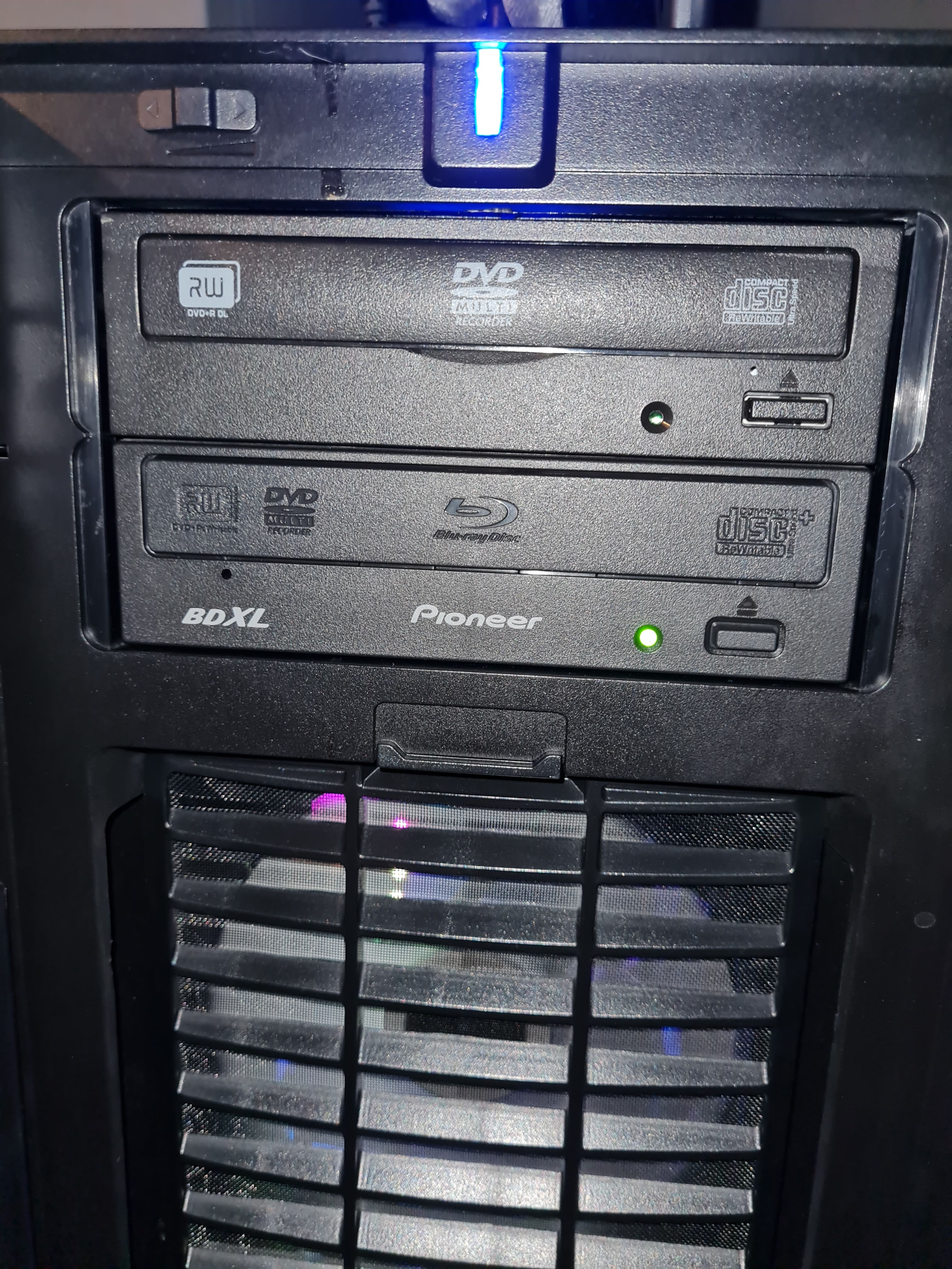

Mine supports BD-XL but wont read UHD discs.
If you put in a UHD disc it just tries to read for awhile before it gives up and shows no disc.

andrewtjb wrote: Mon Feb 14, 2022 5:33 pm Mine supports BD-XL but wont read UHD discs.
Interesting... Another reason to research the cross-flash ability...

Just remember, "BDXL" does not necessarily mean "UHD capable". My 2014 BDXL drive can't see a UHD, because it doesn't read at a high enough bit density.

Woodstock wrote: Mon Feb 14, 2022 6:31 pm Just remember, "BDXL" does not necessarily mean "UHD capable". My 2014 BDXL drive can't see a UHD, because it doesn't read at a high enough bit density.
How old is the drive?
I bought the drive a few years ago but not sure when these drives were first available.
