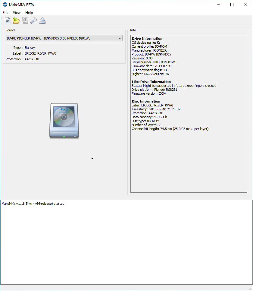

Post by ryley » Sat Feb 12, 2022 11:03 am
Coopervid wrote:
Sat Feb 12, 2022 10:51 am
emrysblack wrote:
Sat Feb 12, 2022 1:19 am
This drive doesn't support UHD.
UHD aside, unless I misread Mike's initial post, I thought it would now support LibreDrive as one of the RS8xxx drives. My experience with an older BDR-XD05 on the RS8231 platform is similar:
Pioneer BDR-XD05.PNG (62.53 KiB) Viewed 85678 times
Posts: 4535
Post by Coopervid » Sat Feb 12, 2022 11:24 am
You should verify that you have internet access allowed since Makemkv needs to update sdf.bin to version 81. If you enable debug you can see which version is used when you rip a disc. If you have version 81 then it needs more work for Mike.
