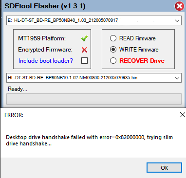

Okay I found a version from the "The all you need firmware pack" but it gives me an error
Annotation 2022-02-08 145109.png (16.84 KiB) Viewed 29161 times
I said BP60NB10 1.00-MK, not 1.02-MK.
Anyway, when you press OK on the handshke message does it work?

Okay so I found the 1.00 version and it did the same thing. When I press okay it flashes something but nothing changes. NB52
NB52 is the issue. It can be done just a slightly different way.
1. Select the RECOVERY option in SDFtool flasher.
2. Choose the current BP50NB40 1.03-MK firmware in the popup.
3. Select the BP60NB10 firmware in the normal drop box.
4. START
If it still doesn't work, do the same again but check the "boot loader" box. Let me know how you go.

Whenever I try anything it just gives me the same error

It's just the same error again. “Desktop drive handshake failed with error=0x82000000, trying slim drive handshake...”

FatNFuri0us1 wrote: Thu Feb 10, 2022 12:14 am
what marty is saying should work i have done it you maybe doing a step wrong.
do you want one of my automated flashers for NB 52?
