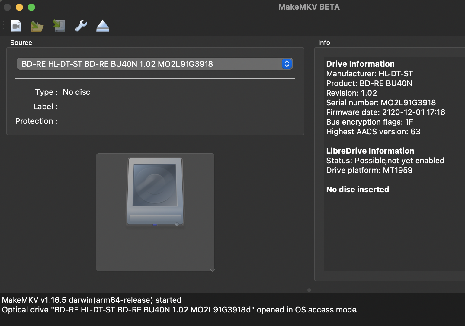

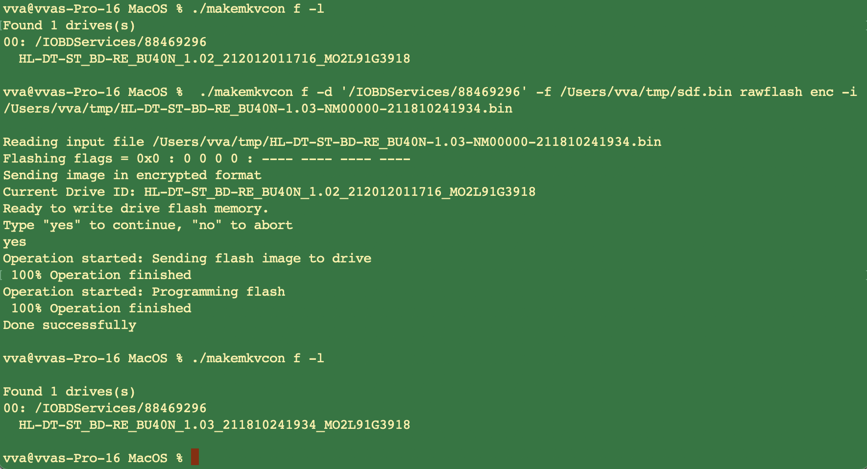

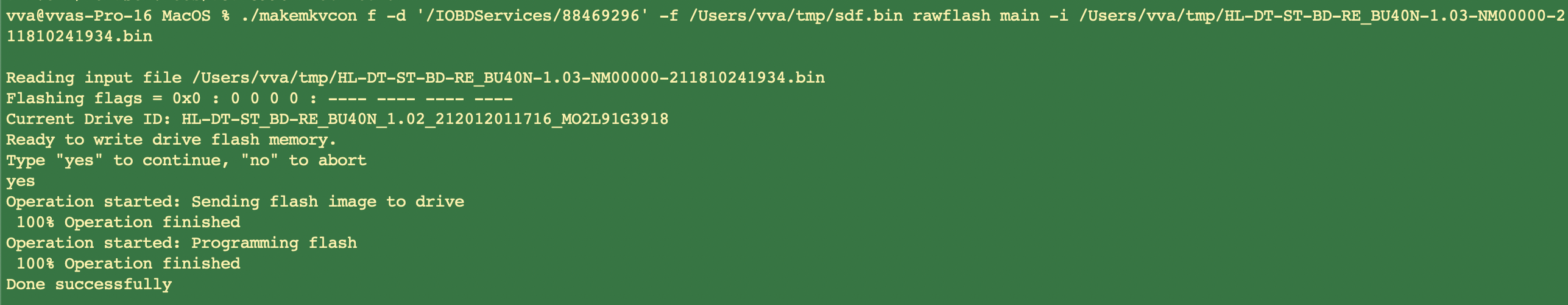

I flashed my drive as per instructions.
Screenshot 2022-02-10 at 17.04.12.png (309.09 KiB) Viewed 17082 times
Everything seemed to work, but it looks like the firmware did not change and the drive remains incapable of reading UHD disks.
Screenshot 2022-02-10 at 17.20.37.png (535.53 KiB) Viewed 17082 times
I assumed VLC should be able to play the film on a flashed drive w. MakeMKV VLC integration checked.
I did this on an M1 Max Macbook Pro with MacOS Monterey 12.1. The drive is an Archgon BD-RE BU40N.
What do I do?
Best Regards CJ

Carl Johan wrote: Thu Feb 10, 2022 4:29 pm What do I do?
Did you power cycle the drive after the flash? Unplug it, wait a few moments and plug it back in.

Carl Johan wrote: Thu Feb 10, 2022 4:29 pm Hello,
What do I do?
Best Regards CJ
I'd say you have the encrypted 1.02 on your BU40N. In your command change "main"to "enc" and try again.

dcoke22 wrote: Thu Feb 10, 2022 7:27 pm
Yes. I tried flashing again using the USB-A connectors. No dice.
CJ
Carl Johan
Joined: Thu Feb 10, 2022 4:19 pm
Post by Carl Johan »
MartyMcNuts wrote: Thu Feb 10, 2022 10:32 pm
That did it:
