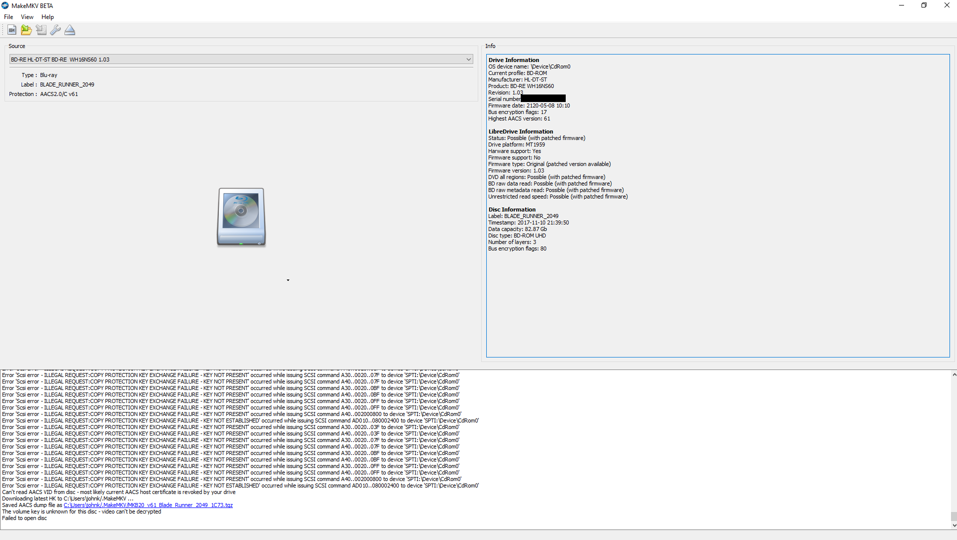

I have a LG drive that isn't flashing
It claims to flash ok :
PS C:\Program Files (x86)\MakeMKV> .\makemkvcon64.exe f --all-yes -d F: rawflash -i C:\Users\johnk\Downloads\HL-DT-ST-BD-RE_WH16NS60-1.02-NM00100-211810291936.bin
Reading input file C:\Users\johnk\Downloads\HL-DT-ST-BD-RE_WH16NS60-1.02-NM00100-211810291936.bin
Current Drive ID: HL-DT-ST_BD-RE__WH16NS60_1.03_212005081010_XXXXXXXXXX
 100% Operation finished
Done successfully
But when I try it afterwards it still lists the original firmware and doesn't work :
Anyone got any suggestions?
