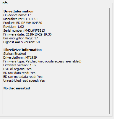

ijomun
- Posts: 4
- Joined: Fri Jan 28, 2022 10:32 pm
Thank you Billy and Coop. Couldn't have done it w/o your help! I'll do just that now. Just a quick check before I do: Use the SDFtool with 'enc' checked?Billycar11 wrote: Sat Jan 29, 2022 11:12 pmYes flash it to WH16NS60 1.02mkijomun wrote: Sat Jan 29, 2022 10:06 pmHi Billy. Thank you for the reply. I read your guide at the beginning of this thread as well as MartyMcNut's guide on the SDFtool Flasher thread. I downloaded the Flasher and the "all you need" firmware pack. It only had firmware for the WH16NS60. Also reading your recommended list of firmware to flash to I saw this: "WH14NS40 on any Firmware directly to > WH16NS60 1.02MK." So I'm now a thoroughly confused. Should I be flashing the WH14NS40 to the WH16NS60 1.02MK, or is there something quite obvious that I'm missing?
ijomun
- Posts: 4
Hi Billy and Coop. Thank you for this. I couldn't have done it without you! Lookie hereBillycar11 wrote: Sat Jan 29, 2022 11:12 pmYes flash it to WH16NS60 1.02mkijomun wrote: Sat Jan 29, 2022 10:06 pmHi Billy. Thank you for the reply. I read your guide at the beginning of this thread as well as MartyMcNut's guide on the SDFtool Flasher thread. I downloaded the Flasher and the "all you need" firmware pack. It only had firmware for the WH16NS60. Also reading your recommended list of firmware to flash to I saw this: "WH14NS40 on any Firmware directly to > WH16NS60 1.02MK." So I'm now a thoroughly confused. Should I be flashing the WH14NS40 to the WH16NS60 1.02MK, or is there something quite obvious that I'm missing?
- successful flash.PNG (11.72 KiB) Viewed 17702 times

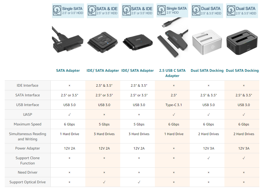

Thank you for your amazing work, I'm here to report that Unitek Y-1039 USB to sata cable is no longer supporting Optical drive, maybe due to new UASP protocol they offered as a feature upgrade.
The official link of this product is:
https://www.unitek-products.com/product ... ta-adapter
From the Amazon US webpage:
https://www.amazon.com/Unitek-Adapter-C ... B00GLL41MA
It says specifically optical drive is not supported.
Out of curious I still ordered one at the price of $15 and I can confirm I get " Device Descriptor Request Failed (Unknown USB device)" error when using it.

In the images of the official link you provided, it still shows SATA ODD.spinning11joy wrote: Mon Jan 31, 2022 6:05 am Thank you for your amazing work, I'm here to report that Unitek Y-1039 USB to sata cable is no longer supporting Optical drive, maybe due to new UASP protocol they offered as a feature upgrade.

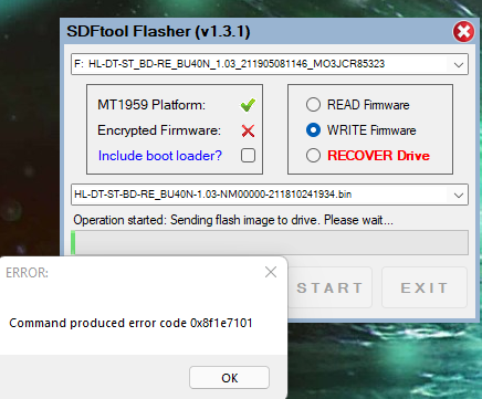

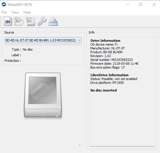

Hey i tried using the SDFtool Flasher and got this error 0x8f1e7101 used the firmware for BU40N in the "The all you need firmware pack" what did i do wrong ?MartyMcNuts wrote: Mon Jan 31, 2022 10:24 pmTry reading the first post in this very thread!norwegianbite wrote: Mon Jan 31, 2022 10:02 am Hey im a noob at this and trying to find the right way to flash my drive, and if it is possible to do so. anyone that can point me in the right way ?![]()
- Skjermbilde 2022-02-01 101306.png (64.9 KiB) Viewed 17553 times
- Posts: 5054
First, ensure that there is no disc in the drive and the tray is closed. Now, try the following one at a time.norwegianbite wrote: Tue Feb 01, 2022 9:16 amHey i tried using the SDFtool Flasher and got this error 0x8f1e7101 used the firmware for BU40N in the "The all you need firmware pack" what did i do wrong ?MartyMcNuts wrote: Mon Jan 31, 2022 10:24 pmTry reading the first post in this very thread!norwegianbite wrote: Mon Jan 31, 2022 10:02 am Hey im a noob at this and trying to find the right way to flash my drive, and if it is possible to do so. anyone that can point me in the right way ?![]()
1. Toggle the drive encryption by clicking on the red X and try flashing again. If this works then it's all good and you can stop now. If not, then proceed.
2. Try flashing the BU40N 1.04 firmware from the MK folder. If this works, you can then try flashing the 1.03 firmware. If it didn't work, toggle the drive encryption back to the red X and repeat this. If it still hasn't worked for you let us know.
