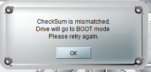

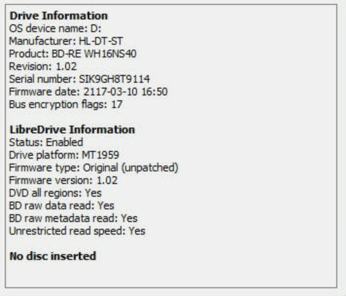

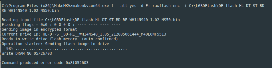

#1107 Post by ijomun » Sat Jan 29, 2022 5:57 pm
Hi, I just purchased a WH14NS40 drive and tried to downgrade the firmware to 1.02 but ran into some problems. It's a MT1959 drive that came with the 1.05 firmware (Image 1)
At first, I tried the Unlock Flasher Tool from @blackened2687 and the YouTube Guide. But when I ran the flasher, I got an error saying "CheckSum is mismatched," followed by a Windows "Program Compatibility" error on the Flasher (Image 2). After doing a little more reading, I came to the conclusion that the firmware on my drive might be encrypted. So I decided to try the Command line approach (the V2 version of the YouTube guide).
This time, it actually went most of the way through the flash but then stopped at 98% and gave me the error: "Command produced error code 0x8f052603." (Image 3). So, now I'm at a loss. Seems like others are doing fine with the tool, but I'm not having any luck either way. I'm including some images of the drive info and the error codes. I'd really appreciate any help, thank you.
LG BDR Drive Info.PNG (13.43 KiB) Viewed 21050 times
BR Drive Flash error.PNG (59.52 KiB) Viewed 21050 times
Command Line (with enc key).png (39.39 KiB) Viewed 21050 times

#1108 Post by Billycar11 » Sat Jan 29, 2022 8:18 pm
ijomun wrote: Sat Jan 29, 2022 5:57 pm Hi, I just purchased a WH14NS40 drive and tried to downgrade the firmware to 1.02 but ran into some problems. It's a MT1959 drive that came with the 1.05 firmware (Image 1)
Read the guide your flashing to the wrong firmware

#1109 Post by Coopervid » Sat Jan 29, 2022 9:11 pm
First flash the same that is on the drive. Means 1.05 MK. Afterwards you can down- or sidegrade.
Billy - the guide is in this regards not easy to understand for someone who is new to the party.
ijomun
Joined: Fri Jan 28, 2022 10:32 pm
#1110 Post by ijomun » Sat Jan 29, 2022 10:06 pm
Billycar11 wrote: Sat Jan 29, 2022 8:18 pm
Hi Billy. Thank you for the reply. I read your guide at the beginning of this thread as well as MartyMcNut's guide on the SDFtool Flasher thread. I downloaded the Flasher and the "all you need" firmware pack. It only had firmware for the WH16NS60. Also reading your recommended list of firmware to flash to I saw this: "WH14NS40 on any Firmware directly to > WH16NS60 1.02MK." So I'm now a thoroughly confused. Should I be flashing the WH14NS40 to the WH16NS60 1.02MK, or is there something quite obvious that I'm missing?
