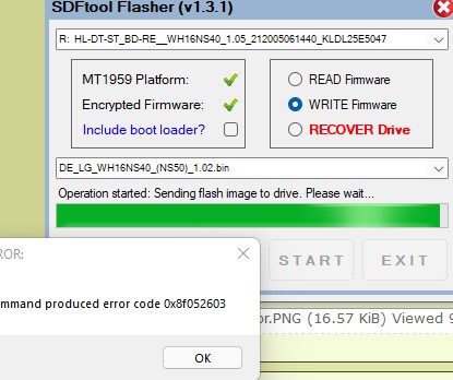

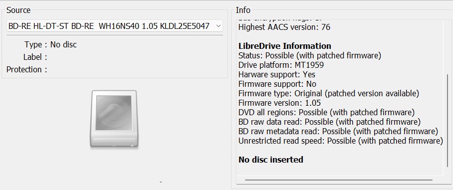

I just purchased a new LG drive, see screenshot from MKV snip and I tried to downgrade the firmware from 1.05 to 1.02 but I keep getting the error shown in screenshot error. I am running windows 11, shouldn't make a difference I would think. Am I using the wrong firmware or is it some other issue? I tried both encrypted and unencrypted with the program but got the same error.

That's because you're trying to flash DE firmware. You need to use MK firmware from THIS THREADvmax5000 wrote: Sat Jan 22, 2022 9:03 pm I just purchased a new LG drive, see screenshot from MKV snip and I tried to downgrade the firmware from 1.05 to 1.02 but I keep getting the error shown in screenshot error. I am running windows 11, shouldn't make a difference I would think. Am I using the wrong firmware or is it some other issue? I tried both encrypted and unencrypted with the program but got the same error.

You cannot flash directly to WH16NS40 1.02 from the encrypted 1.05. Also, the best (and recommended) firmware for your drive is WH16NS60 1.02-MK, which can be flashed to directly.vmax5000 wrote: Sat Jan 22, 2022 9:03 pm I just purchased a new LG drive, see screenshot from MKV snip and I tried to downgrade the firmware from 1.05 to 1.02 but I keep getting the error shown in screenshot error. I am running windows 11, shouldn't make a difference I would think. Am I using the wrong firmware or is it some other issue? I tried both encrypted and unencrypted with the program but got the same error.
