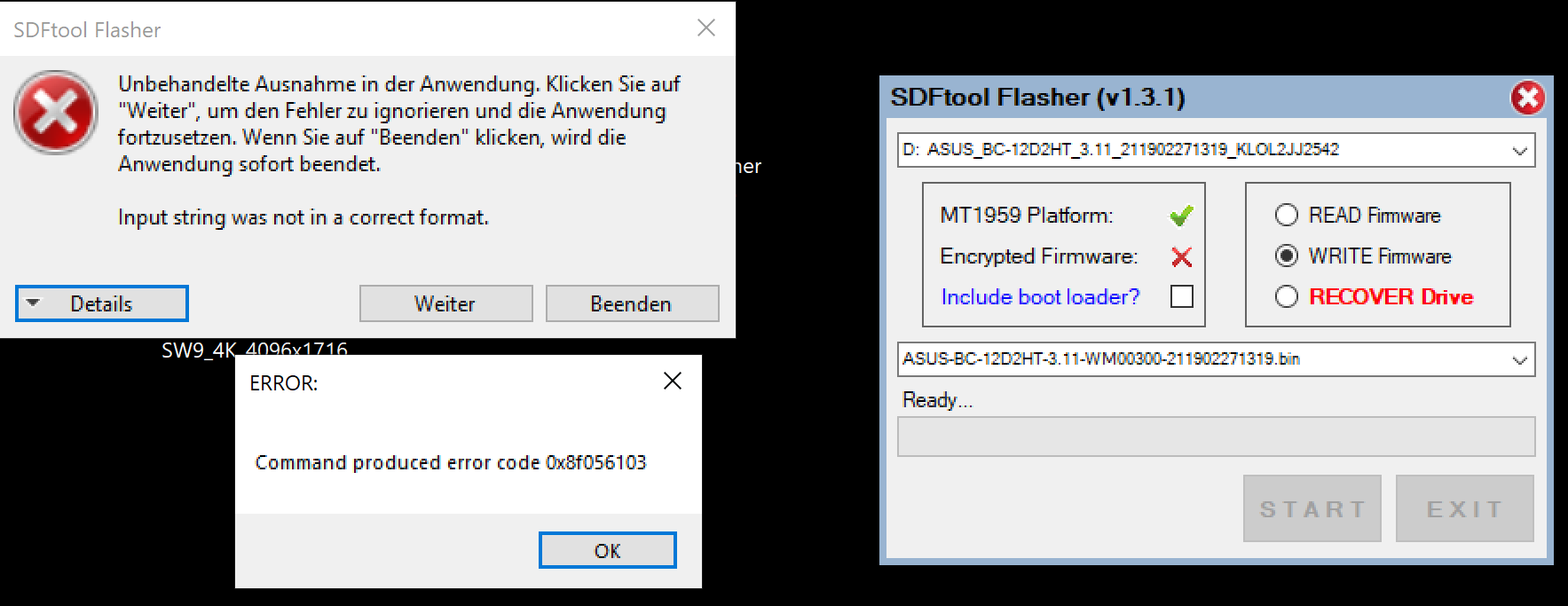

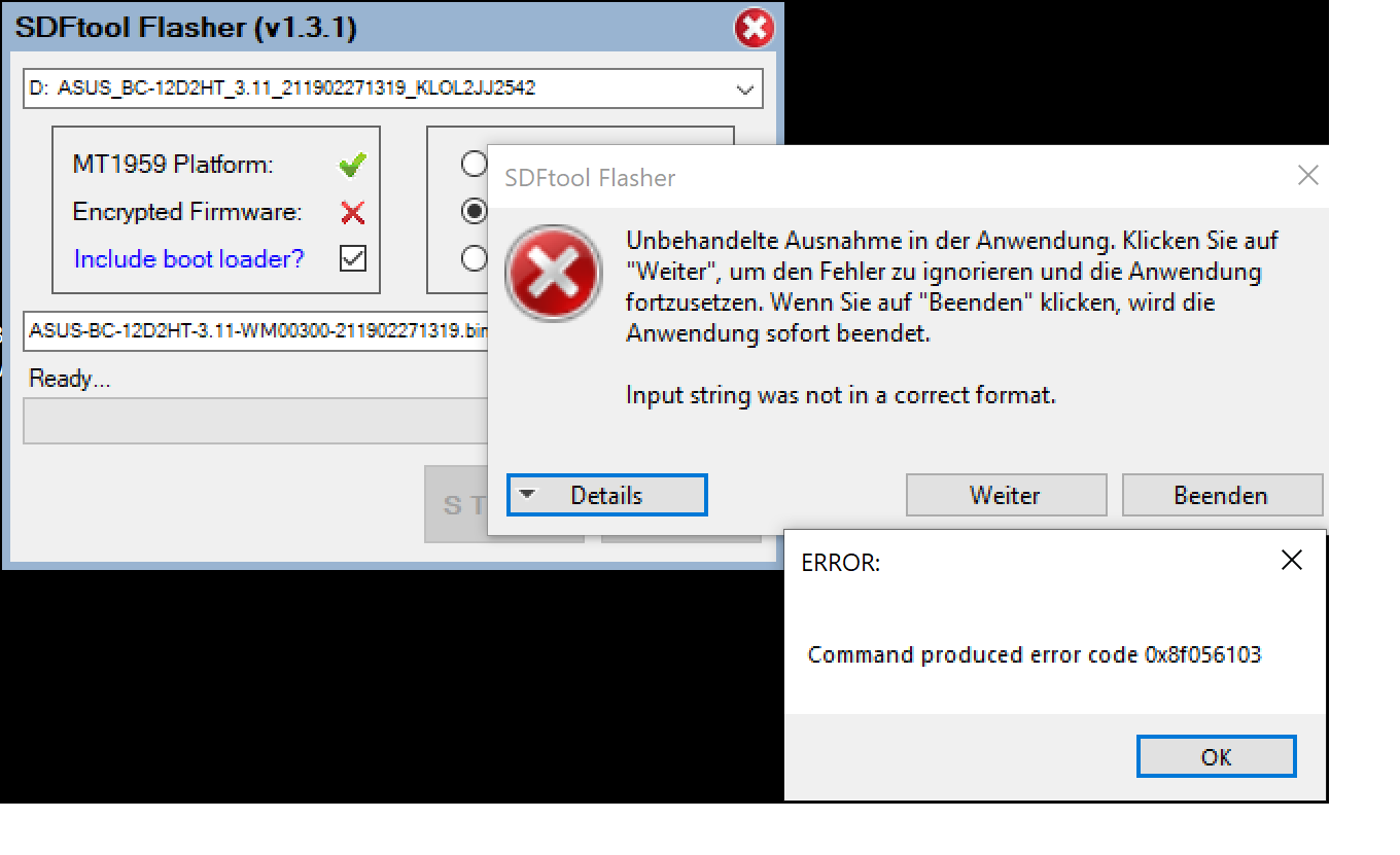

thank you, but her is what happened
what did i wrong?

DO NOT use the bootloader option for that drive. Didn't you read the CAUTION note when hovering mouse over it?
yes, but what can i do now? if i dont use it, i get this
Try using the old version of the flasher. See if that helps. DL from first post. If that doesn't work either try using the "modified ASUS flasher"
Edit: Allright, i think it worked!
