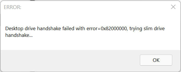

Hey all,
Just purchased a BP50NB40, and started the UHD flashing process.
I first flashed with the MK firmware using the SDF Flash tool (from the "The all you need firmware pack", and the following is what I've got:
Looks good.
I then attempted to flash the BP60NB10 firmware. SDFTool gives me the following warning, but then proceeds to flash "OK". However, when opening MakeMKV, there's no change to the firmware - hence no UHD for me.
Have I missed something?

Ugh! Looked at the box - and it has NB52 for it's SVC code. But I looks like I was able to flash an MK firmware onto it ...lordvader wrote: ↑Fri Dec 17, 2021 4:48 amHey all,

Drive Information OS device name: E: Manufacturer: HL-DT-ST Product: BD-RE BP50NB40 Revision: 1.03 Serial number: SIK01L99G0500 Firmware date: 2120-05-07 09:17 Bus encryption flags: 17 Highest AACS version: 12 LibreDrive Information Status: Enabled Drive platform: MT1959 Firmware type: Patched (microcode access re-enabled) Firmware version: 1.03 DVD all regions: Yes BD raw data read: Yes BD raw metadata read: Yes Unrestricted read speed
Weird
Re: Ultimate UHD Drives Flashing Guide Updated 2021
Not weird - great!
