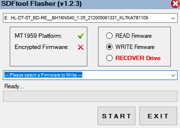

Post by mm8718 » Sat Nov 06, 2021 11:56 am
@MartyMcNuts
I need some help
I am getting pretty consistent failed rips with my hardware but not always.
In the last week i just tried ripping Jungle cruise UHD and THOR Dark World UHD and they are both failing. I tried MakeMKV and DVD Fab UHD Rip with the same issues. Contrary to that an older UHD copy of Se7en worked fine.
DVD Fab has a tool to adjust the firmware and it seems to suggest the 1.02 is needed whereas i have 1.05 which works some times!
Can someone help? I would rather not pay the extortionate fee for DVD fab Drive tool!
Here's my drive details:
Product: BD-RE BH16NS40
Revision: 1.05
Serial number: KL7KAT81109
Firmware date: 2120-05-06 13:31
Highest AACS version: 76
Firmware version: 1.05
And here is what the SDF write sees:
SDF Drive Details
SDF Drive Details
SDF Write.PNG (10.48 KiB) Viewed 21415 times
Posts: 4645
Re: SDFtool Flasher
Post by Coopervid » Sat Nov 06, 2021 12:26 pm
Look on page 1 of this thread and download the DE firmware pack. It contains 1.02.

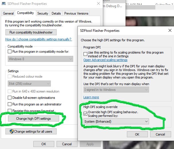

Marty,
the GUI is hosed on my 4k monitor. The text does not fully show and I am unable to move or resize the GUI.
Thank you for your software, it has served me well in the past.
Cheers.
Posts: 4645
Re: SDFtool Flasher
Post by Coopervid » Sat Nov 06, 2021 8:51 pm
Just reduce the resolution for the time being.
Posts: 4989
Re: SDFtool Flasher
Post by MartyMcNuts » Sat Nov 06, 2021 10:01 pm
revengineer wrote: Sat Nov 06, 2021 1:22 pm 2021-11-06.pngMarty,
Cheers.
Can you please try adjusting the DPI settings of the SDFtool flasher exe file as per below.
DPI Settings.jpg (100.58 KiB) Viewed 21383 times
Let me know if this helps.

Post by revengineer » Sun Nov 07, 2021 12:36 pm
MartyMcNuts wrote: Sat Nov 06, 2021 10:01 pm Can you please try adjusting the DPI settings of the SDFtool flasher exe file as per below.
I confirm that this works. Thank you so much!

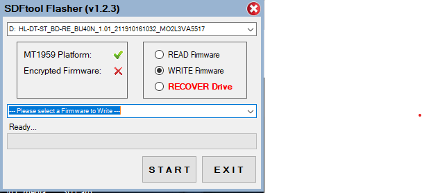

Post by cloudyapple » Tue Nov 16, 2021 12:56 pm
Have the below Archgon drive purchased from Amazon.
Loaded up the GUI flasher and the MK firmwares.
I heard this is the same as the LG BU40N, but there are many choices for this.
Which version should I choose?
Do I have an encrypted firmware currently and need to check some box?
Screenshot 2021-11-16 204110.png (16.84 KiB) Viewed 21213 times
Product: BD-RE BU40N
Revision: 1.01
Serial number: MO2L3VA5517
Firmware date: 2119-10-16 10:32
Bus encryption flags: 1F
Highest AACS version: 61
Harware support: Yes
Firmware support: No
Firmware version: 1.01
Posts: 4989
Re: Archgon drive
Post by MartyMcNuts » Tue Nov 16, 2021 9:20 pm
cloudyapple wrote: Tue Nov 16, 2021 12:56 pm Have the below Archgon drive purchased from Amazon.
Revision: 1.01
As you can see, the SDFtool Flasher tells you that the drive does not have encrypted firmware (the red X beside "Encrypted firmware"). Just flash DE_LG_BU40N_1.00 firmware and be done with it. Start ripping your UHD discs.

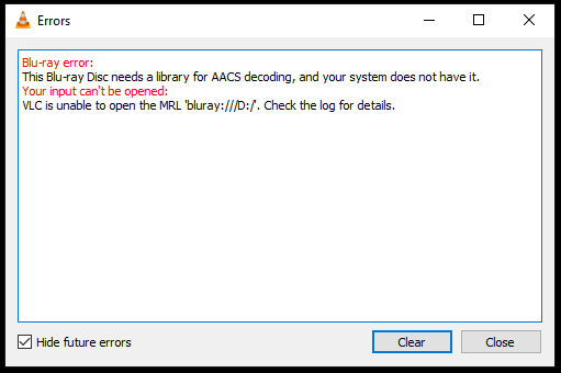

It does however looks like VLC doesn't play a UHD disc.
Am I right it is meant to be a ripping drive, not really a directly playable drive, i.e. no way to directly play it correct?
screenshot_VLC error.png (9.97 KiB) Viewed 21182 times
Mr_Orange
Posts: 226
Re: SDFtool Flasher
Post by Mr_Orange » Wed Nov 17, 2021 2:06 am
The firmware enables ripping.
You can set up VLC integration from the Preferences in MakeMKV.
