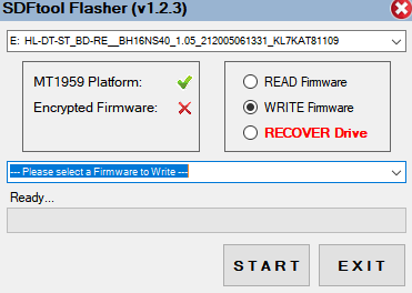

#336 Post by mm8718 » Sat Nov 06, 2021 11:56 am
@MartyMcNuts
I need some help
I am getting pretty consistent failed rips with my hardware but not always.
In the last week i just tried ripping Jungle cruise UHD and THOR Dark World UHD and they are both failing. I tried MakeMKV and DVD Fab UHD Rip with the same issues. Contrary to that an older UHD copy of Se7en worked fine.
DVD Fab has a tool to adjust the firmware and it seems to suggest the 1.02 is needed whereas i have 1.05 which works some times!
Can someone help? I would rather not pay the extortionate fee for DVD fab Drive tool!
Here's my drive details:
Product: BD-RE BH16NS40
Revision: 1.05
Serial number: KL7KAT81109
Firmware date: 2120-05-06 13:31
Highest AACS version: 76
Firmware version: 1.05
And here is what the SDF write sees:
SDF Drive Details
SDF Drive Details
SDF Write.PNG (10.48 KiB) Viewed 20157 times
Posts: 4533
Re: SDFtool Flasher
#337 Post by Coopervid » Sat Nov 06, 2021 12:26 pm
Look on page 1 of this thread and download the DE firmware pack. It contains 1.02.
viewtopic.php?f=16&t=22896

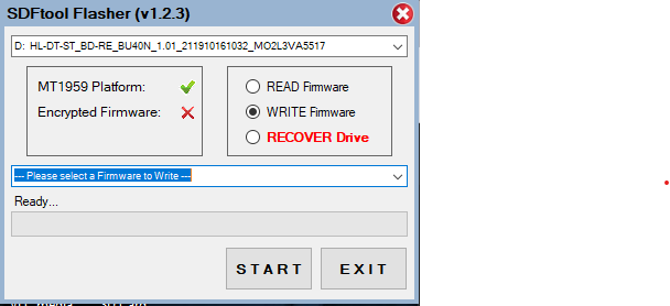

#342 Post by cloudyapple » Tue Nov 16, 2021 12:56 pm
Have the below Archgon drive purchased from Amazon.
Loaded up the GUI flasher and the MK firmwares.
I heard this is the same as the LG BU40N, but there are many choices for this.
Which version should I choose?
Do I have an encrypted firmware currently and need to check some box?
Screenshot 2021-11-16 204110.png (16.84 KiB) Viewed 19958 times
Product: BD-RE BU40N
Revision: 1.01
Serial number: MO2L3VA5517
Firmware date: 2119-10-16 10:32
Bus encryption flags: 1F
Highest AACS version: 61
Harware support: Yes
Firmware support: No
Firmware version: 1.01
Posts: 4900
Re: Archgon drive
#343 Post by MartyMcNuts » Tue Nov 16, 2021 9:20 pm
Revision: 1.01
As you can see, the SDFtool Flasher tells you that the drive does not have encrypted firmware (the red X beside "Encrypted firmware"). Just flash DE_LG_BU40N_1.00 firmware and be done with it. Start ripping your UHD discs.

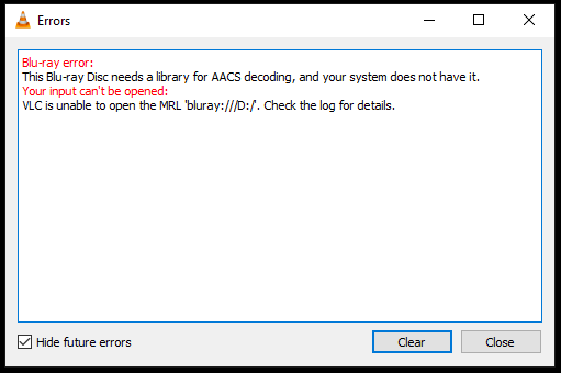

#344 Post by cloudyapple » Tue Nov 16, 2021 10:52 pm
Thanks a lot Marty, look like it is done!
What a great tool!
Revision: 1.00
Firmware date: 2116-12-20 15:28
Firmware version: 1.00
It does however looks like VLC doesn't play a UHD disc.
Am I right it is meant to be a ripping drive, not really a directly playable drive, i.e. no way to directly play it correct?
screenshot_VLC error.png (9.97 KiB) Viewed 19926 times
Mr_Orange
Posts: 224
Re: SDFtool Flasher
#345 Post by Mr_Orange » Wed Nov 17, 2021 2:06 am
The firmware enables ripping.
You can set up VLC integration from the Preferences in MakeMKV.
