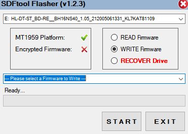

Re: SDFtool Flasher
Post by mm8718 »
@MartyMcNuts
I need some help
I am getting pretty consistent failed rips with my hardware but not always.
In the last week i just tried ripping Jungle cruise UHD and THOR Dark World UHD and they are both failing. I tried MakeMKV and DVD Fab UHD Rip with the same issues. Contrary to that an older UHD copy of Se7en worked fine.
DVD Fab has a tool to adjust the firmware and it seems to suggest the 1.02 is needed whereas i have 1.05 which works some times!
Can someone help? I would rather not pay the extortionate fee for DVD fab Drive tool!
Here's my drive details:
Product: BD-RE BH16NS40
Revision: 1.05
Serial number: KL7KAT81109
Firmware date: 2120-05-06 13:31
Highest AACS version: 76
Firmware version: 1.05
And here is what the SDF write sees:
Posts: 4815
Re: SDFtool Flasher
Look on page 1 of this thread and download the DE firmware pack. It contains 1.02.
viewtopic.php?f=16&t=22896

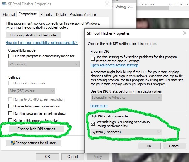

revengineer
Joined: Sun Jan 03, 2021 8:26 pm
Re: SDFtool Flasher
Post by revengineer »
Marty,
the GUI is hosed on my 4k monitor. The text does not fully show and I am unable to move or resize the GUI.
Thank you for your software, it has served me well in the past.
Cheers.
Posts: 4815
Re: SDFtool Flasher
Just reduce the resolution for the time being.
Posts: 5109
Re: SDFtool Flasher
revengineer wrote: Sat Nov 06, 2021 1:22 pm 2021-11-06.pngMarty,
Cheers.
Can you please try adjusting the DPI settings of the SDFtool flasher exe file as per below.
Let me know if this helps.
revengineer
Re: SDFtool Flasher
MartyMcNuts wrote: Sat Nov 06, 2021 10:01 pm Can you please try adjusting the DPI settings of the SDFtool flasher exe file as per below.
I confirm that this works. Thank you so much!

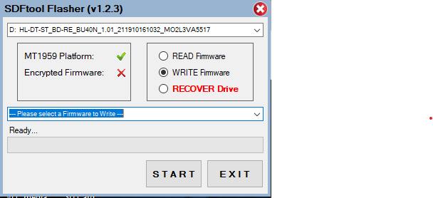

cloudyapple
Joined: Tue Nov 16, 2021 12:44 pm
Archgon drive
Post by cloudyapple »
Have the below Archgon drive purchased from Amazon.
Loaded up the GUI flasher and the MK firmwares.
I heard this is the same as the LG BU40N, but there are many choices for this.
Which version should I choose?
Do I have an encrypted firmware currently and need to check some box?
Product: BD-RE BU40N
Revision: 1.01
Serial number: MO2L3VA5517
Firmware date: 2119-10-16 10:32
Bus encryption flags: 1F
Highest AACS version: 61
Harware support: Yes
Firmware support: No
Firmware version: 1.01
Posts: 5109

cloudyapple wrote: Tue Nov 16, 2021 12:56 pm Have the below Archgon drive purchased from Amazon.
Revision: 1.01
As you can see, the SDFtool Flasher tells you that the drive does not have encrypted firmware (the red X beside "Encrypted firmware"). Just flash DE_LG_BU40N_1.00 firmware and be done with it. Start ripping your UHD discs.
cloudyapple
Re: SDFtool Flasher
Thanks a lot Marty, look like it is done!
What a great tool!

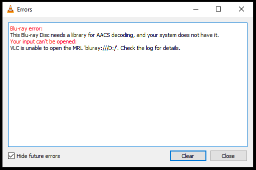

Revision: 1.00
Firmware date: 2116-12-20 15:28
Firmware version: 1.00
It does however looks like VLC doesn't play a UHD disc.
Am I right it is meant to be a ripping drive, not really a directly playable drive, i.e. no way to directly play it correct?
Mr_Orange
Posts: 232
Re: SDFtool Flasher
Post by Mr_Orange »
The firmware enables ripping.
You can set up VLC integration from the Preferences in MakeMKV.
