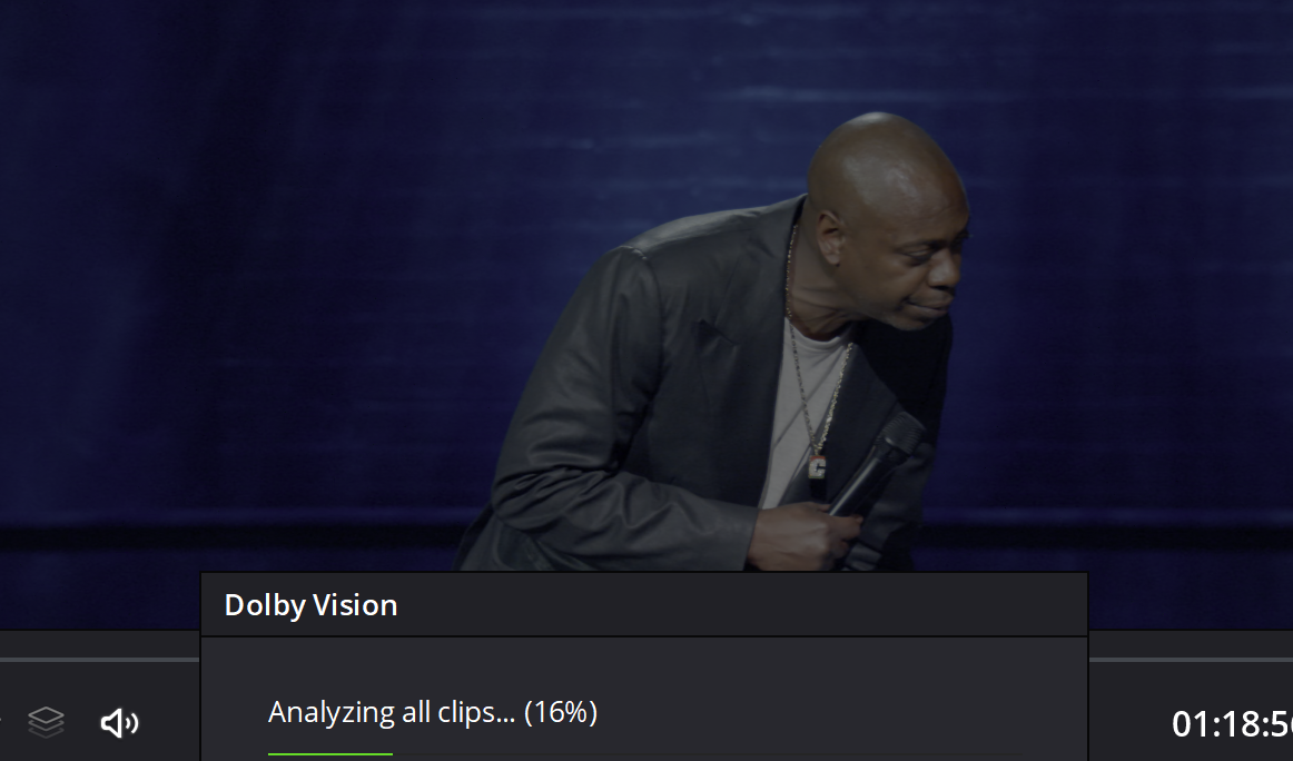

chros wrote: ↑Sat Oct 09, 2021 8:44 amjust generated a profile 08.06 from an HDR10 sample, plays fine with internal Plex app: 04-2160p_23fps_dovi_p81-l_s02e01_cyan_error.ts
To me, it looks like madVR is including the black bars in the measurement because all the min L1 values are 0 in your DV sample. Could be just a different scene cut though.
If I don't set the correct blanking in resolve, I also get 0 everywhere. If set correctly, then I get my first min 0 at exactly 14sec ( frame 343)
otherwise, the max and avg numbers are pretty close. I did not check for a visual difference, only checked the metadata.
I generated metadata using Davinci Resolve Dolby Vision algorithm(same algo studios use). Here's how the L1 metadata compares to madVR for this Netflix clip.

That's 0 because madvr doesn't produce any info about min_pq per frame, jast as hdr10+ (as quietvoid and manixx suggested)RESET_9999 wrote: ↑Mon Oct 11, 2021 3:39 pmTo me, it looks like madVR is including the black bars in the measurement because all the min L1 values are 0 in your DV sample. Could be just a different scene cut though.chros wrote: ↑Sat Oct 09, 2021 8:44 amjust generated a profile 08.06 from an HDR10 sample, plays fine with internal Plex app: 04-2160p_23fps_dovi_p81-l_s02e01_cyan_error.ts
It's Amazon hdr10+. Thanks for the test, measurement results are pretty close indeed (apart from the first avg value, where it's double), really interesting:RESET_9999 wrote: ↑Mon Oct 11, 2021 3:39 pmI generated metadata using Davinci Resolve Dolby Vision algorithm(same algo studios use). Here's how the L1 metadata compares to madVR for this Netflix clip.
- Resolve L6 maxCLL is set to 1680, but it measure more than 3000 nits? what's the unit of the values on the image, nits or PQ?
- - interestingly that's the measurement summary from madvr: MaxCLL 100%: 1680, 99.9%: 1545, MaxFALL: 58, AvgFALL: 9, AvgFMLL: 524 nits
- Resolve set some L2 trim properties (that obviously dovi_tool doesn't by default), why is that? Did you set it or is it automatic?
- Resolve has 3 blocks of L2 metadata, why is that? (target_max_pq: 2081, 2851, 3079; dovi_tool has just 1: 3079) Which one is used during playback?
Manixx2020beyound wrote: ↑Mon Oct 11, 2021 11:40 amMin pq is mostly set to 0 on hdr10plus ... n true min pq value dv dynamic meta it varies more often
Thanks, my question is what the effect of min_pq value is in reality.RESET_9999 wrote: ↑Mon Oct 11, 2021 3:39 pmIf I don't set the correct blanking in resolve, I also get 0 everywhere. If set correctly, then I get my first min 0 at exactly 14sec ( frame 343)
@quietvoid, can we overwrite an L2 value in RPU easily, if so how? (e.g. min_pq to 12) Or we have to export it into json and manually replace them and then reinjecting it?
One block for every target display peak brightness, so that creatives can adjust to their liking for the whole range of brightness.
In playback, you'd have to figure out what the TV says it can output, this might be the same peak as in the Dolby Vision configuration files used for calibration.
This is why I set multiple blocks to the same values in my L2 test sample.
You're asking for L2 but min_pq is L1 metadata.
Technically it could be added to the editor but I don't really see a good use case for it..

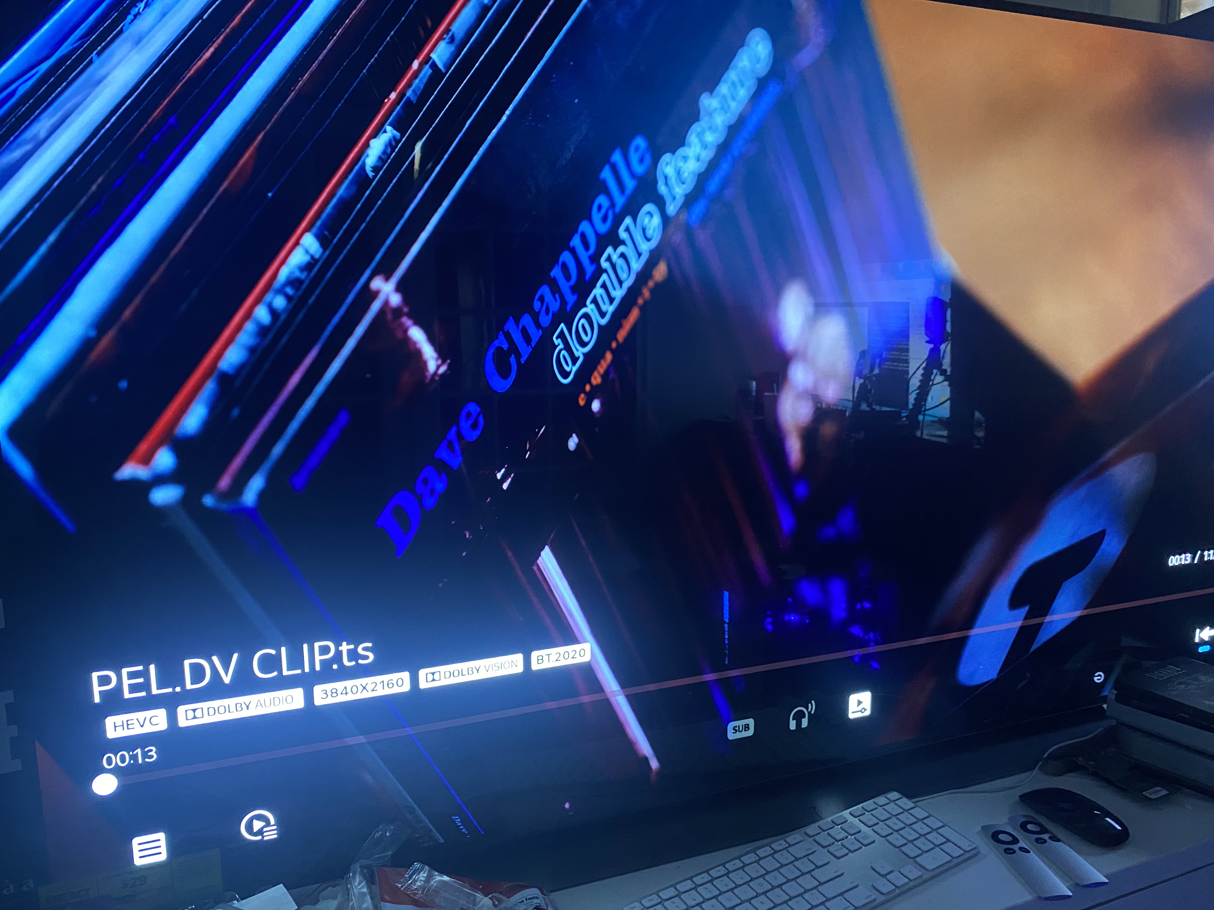

- Posts: 127
- Joined: Thu Oct 08, 2020 5:19 pm
Be interesting to find out what mad Vr considers as the active area.
Did anyone try a movie without black bars to see if the min values changed?
- FD7C10F9-5E3D-4F06-87CE-761653249908.jpeg (2.56 MiB) Viewed 17669 times
Last edited by Manixx2020beyound on Tue Oct 12, 2021 1:35 pm, edited 1 time in total.
