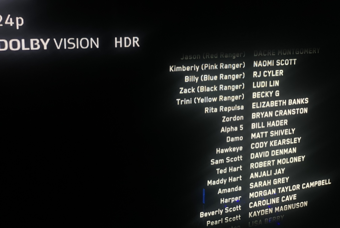

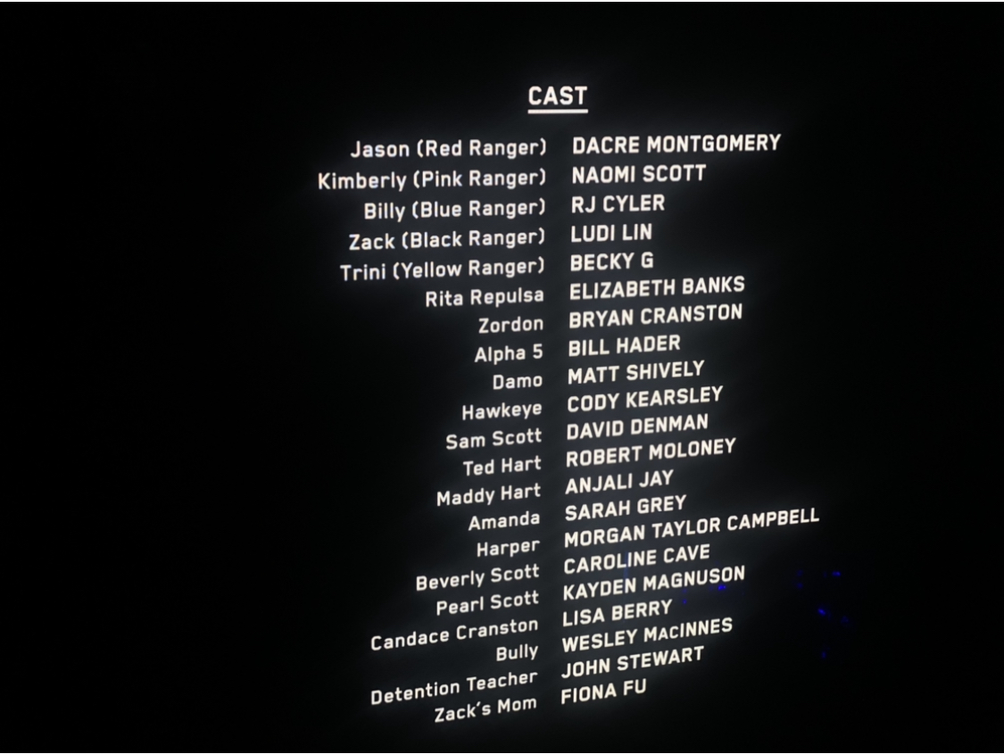

We are not defeated at all, there is a way,staknhalo wrote: Mon Oct 04, 2021 9:35 pmYeah as I mentioned previously, I have not been able to encode a single BL and mux back in its FEL (or even convert that FEL+then encoded BL to 8 ) without there being RPU sync errors/flashes in the file, somewhere, eventually (not always right at the start nor constant). I've tried x265/ffmpeg/though Staxrip UI/Handbrake/various encode settings multiple times/different rip and mux tools and differing versions of each program/yusesope's or quietvoid's tool - there's always a RPU errors eventually in a FEL title no matter what I do with it if I first encode the BL. MEL titles with encoded BL or 8 converted from 5 RPU + encoded HDR10 BL or HDR10+ to 8 with encoded BL - no problem whatsoever on any of those titles (I think I'm at mid-50s currently for native Dovi UHD titles I've added to Plex). I know others here say they're doing it, but I somehow am just SOL apparently. So any FEL title I just mux together and leave untouched - using external forced subs works fine in Plex so I don't need to worry about burning them in (main reason for encoding, secondary to the space saving aspect) - and being I have the source PGS subs, timing/spelling is accurate and all that jazz for my external subs, no worries.
Still, sucks being defeated![]()
I have just created a flawless copy of power rangers just for this test. FEL is 7gigs on power rangers don’t encode it.
18 gig base layer encode with FEL & RPU
You have to edit the FEL (has the nal unit) in the Rpu to reflect the hevc bl encode and that’s it.
I get no flashes no pixilation perfect alinement. Perfect profile 7 with encoded base layer
Inject the new Rpu into the FEL.
Mux with base layer in ts muxer nightly build & your done.
The hard part is getting a new Rpu.
- BC96AF50-7120-4036-A9AE-A0CECD5B5961.jpeg (438.25 KiB) Viewed 39896 times
Last edited by Manixx2020beyound on Tue Oct 05, 2021 7:06 am, edited 1 time in total.
