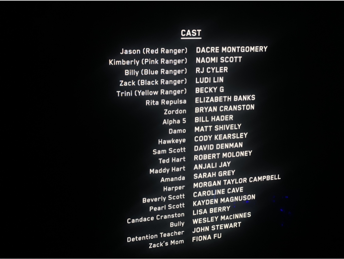

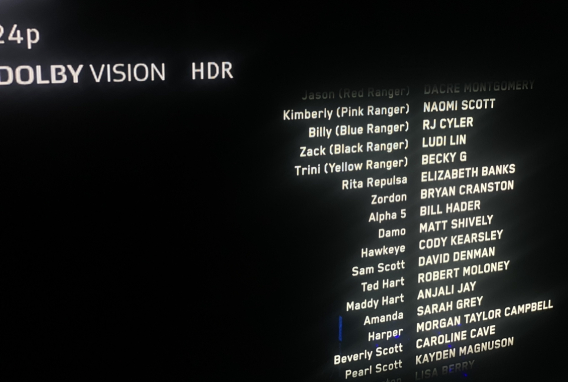

I have just created a flawless copy of power rangers just for this test. FEL is 7gigs on power rangers don’t encode it.
18 gig base layer encode with FEL & RPU
You have to edit the FEL (has the nal unit) in the Rpu to reflect the hevc bl encode and that’s it.
I get no flashes no pixilation perfect alinement. Perfect profile 7 with encoded base layer
Inject the new Rpu into the FEL.
Mux with base layer in ts muxer nightly build & your done.
The hard part is getting a new Rpu.

As @FubbAyH said, the ending credits of Power Ranger is a better way to verify if FEL is processed.
