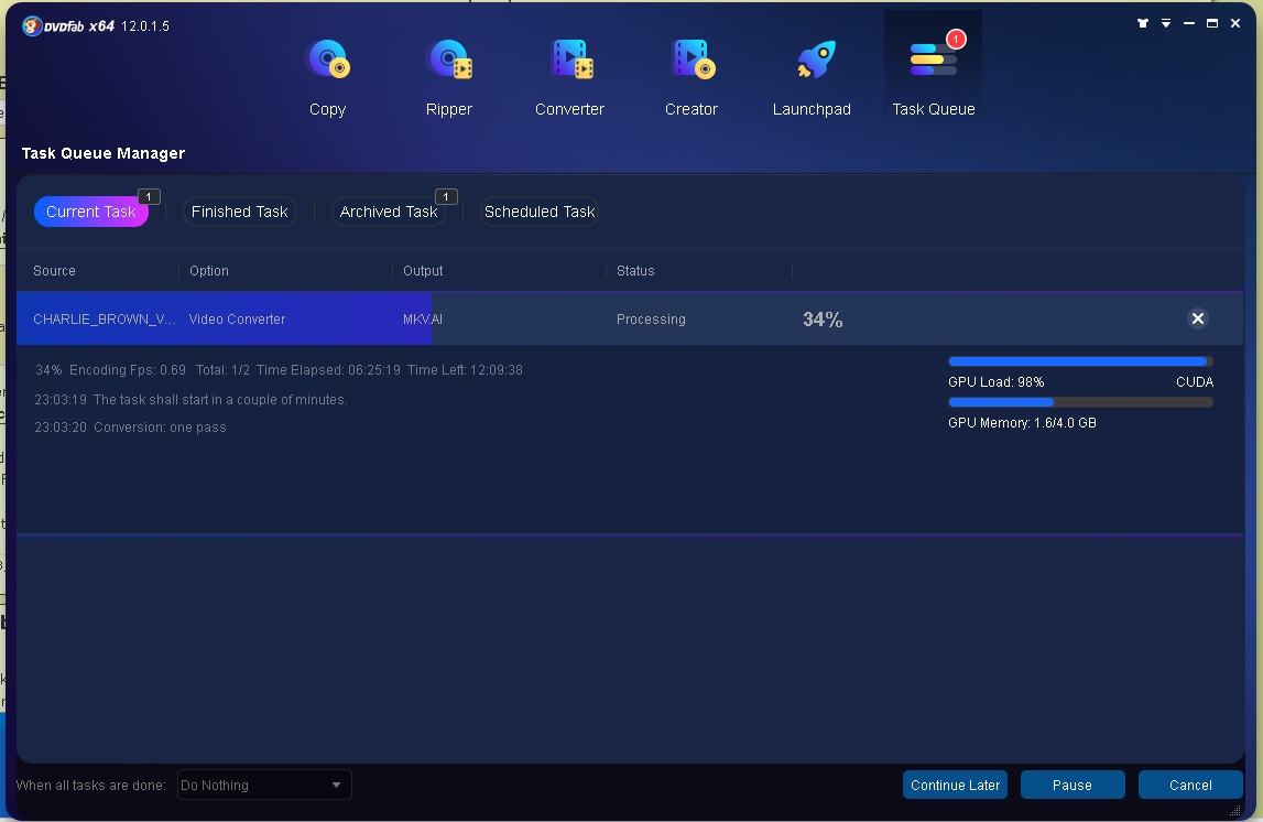

Here it is running. I am using a new i5 running north of 4GZ, 12GB ram, my hard drive for windows is not a HDD or a SDD, it is a Samsung 970 EVO M.2 with a read speed of 3,400 MB per sec. Really a SSD that can read write at about 500MB per sec will do fine as this program DOES NOT use a HD the same way a video editing program does. My graphics card is an NVIDIA GEFORCE GTX 1050 ti, so you do need a good card. Follow the specs published by DVD FAB. Their software can communicate with certain bios on graphics cards only. So it is not only about having a card with lots of CUDA cores. That is not how programming code works... So have a good card their software can talk to. It was only about $200 for the card and it runs games very well, like Battle Front star wars, or Red Dead, or Terminator Resistance all on max settings. So here is DVD FAB working to upgrade Charlie Brown christmas on DVD up to 1080p running:
DVD FAB AI running.jpg (104.25 KiB) Viewed 70212 times

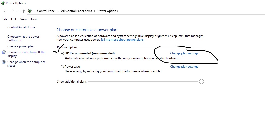

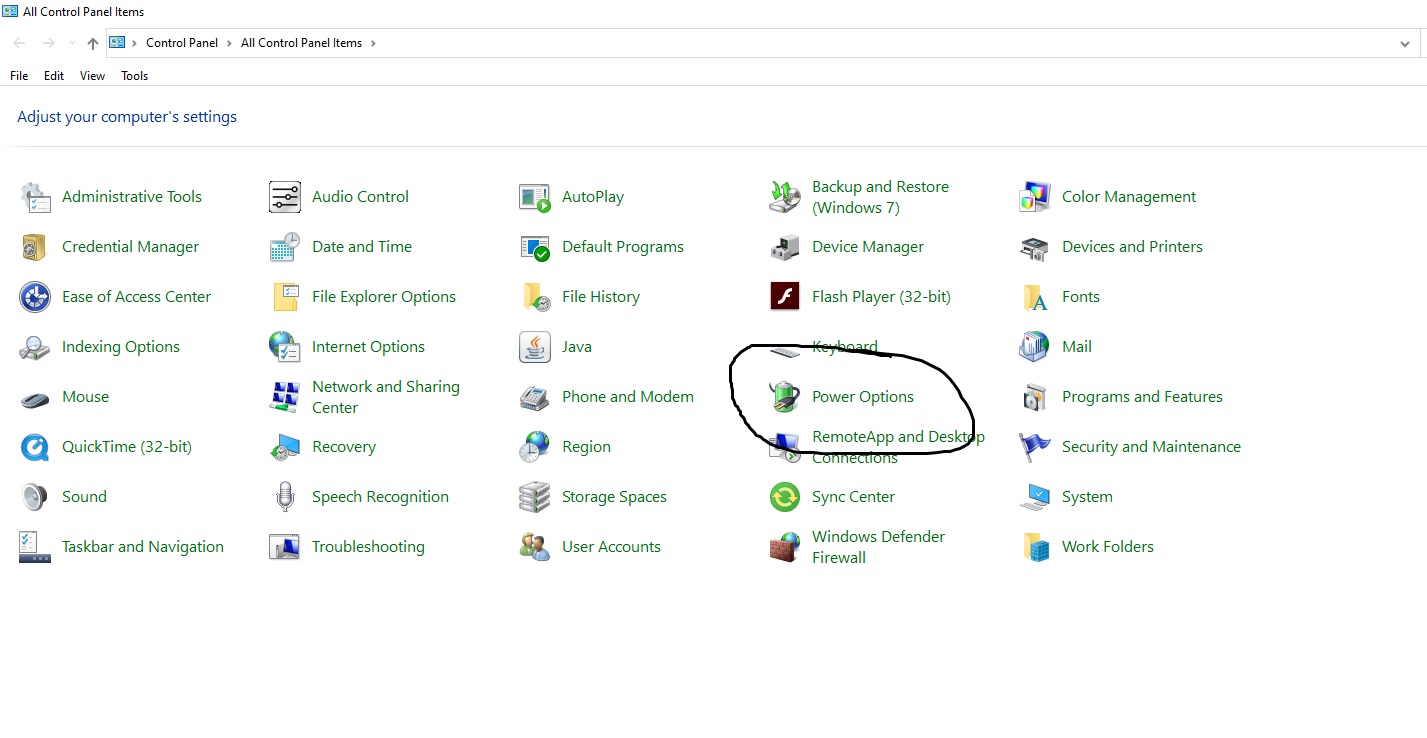

Here are screen shots of the windows settings you must change:
DVD FAB AI - fix windows 1.jpg (149.61 KiB) Viewed 70212 times
DVD FAB AI - fix windows 2.jpg (82.08 KiB) Viewed 70212 times
this Make MKV interface will not let me upload all my screen shots. Grrr. I have a list of shots to make it easy for folks. www.makemkv.com server will only let me upload 3 pics. sorrry.
There are many settings in advanced power management, you must turn ALL OF THEM OFF that you can find. In windows 10 there are like 8-10 settings you must turn off.
