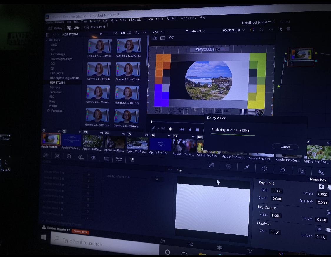

Manixx2020beyound wrote: Tue Aug 31, 2021 6:14 pm @quietvoid
Matching the dynamic meta using the analysis tool compared to a real decoded p5 rpu
If we split/scene @ different points when using the doblyvision analysis tool (resolve)
Xml dynamic meta should be different compared to an original master bc the scene
Selected is diff from the original I’m I correct in this theory?
So far I have changes in my l1 for scene
In other words knowing where the colorist desided to split the clip for analysis bc that’s where the scene changes take place
I'm not following.
The metadata from analysis on the master and encoded video are going to be different, because the encode could introduce errors.
You can get scene cuts by find frames where the RPU has scene_refresh_flag=1, by exporting to JSON and doing a grep or something.
Usually, the L1 metadata is the same for a shot (or scene), but it can possibly be adjusted by frame as well.
Does that answer anything?

Post by Manixx2020beyound »
quietvoid wrote: Tue Aug 31, 2021 9:07 pm
I'm not following.
Ment in the creation of the master before the xml is created
Hdr10 plus/ Dolby Vision anchor points for each scene creation,
We determined where the tool should analyze
quietvoid
Posts: 377
Post by quietvoid »
Manixx2020beyound wrote: Tue Aug 31, 2021 11:34 pm Ment in the creation of the master before the xml is created
Ok, I'm not sure how Resolve does the analysis.
Either it calculates a maximum per shot and uses that, or something else.
So if you want to match L1 closest to the original RPU, you should set the shots in Resolve the same.
