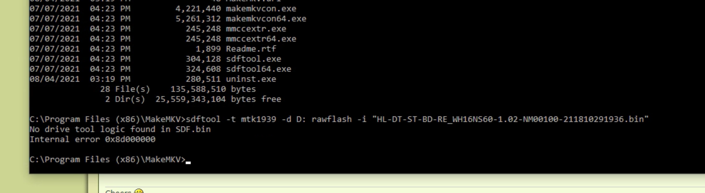

SteelBookCollector
Joined: Fri Aug 20, 2021 1:40 pm
Re: SDFtool Flasher
#290 Post by SteelBookCollector » Mon Aug 23, 2021 8:45 pm
MartyMcNuts wrote: Sat Aug 21, 2021 1:14 am
SteelBookCollector wrote: Fri Aug 20, 2021 1:47 pm Got a brand new WH16NS40 with 1.05 Firmware.
SDFTool v1.2.0, trying to flash to WH16NS60 v1.02 from the old folder, check the enc box.
Getting error code 0x8f056103
On Windows 10 X64. dotNet newer then 4.7.2
What am I doing wrong?
How is your drive connected?
Do you have MakeMKV 1.15.1 or above instlled?
Drive connected directly via SATA,
MakeMKD 1.16.4 installed
SteelBookCollector
Re: SDFtool Flasher
#291 Post by SteelBookCollector » Mon Aug 23, 2021 8:46 pm
Billycar11 wrote: Sat Aug 21, 2021 12:41 am
that should have worked try the command line.
Screen Shot 2021-08-23 at 4.43.35 PM.png (725.33 KiB) Viewed 32074 times

#292 Post by Billycar11 » Tue Aug 24, 2021 1:06 am
SteelBookCollector wrote: Mon Aug 23, 2021 8:46 pm
open a bluray in makemkv then try again and make sure allow server updates is on

#293 Post by Coopervid » Tue Aug 24, 2021 9:23 am
Your command line includes -mtk1939 but this drive uses the 1959 chip.
