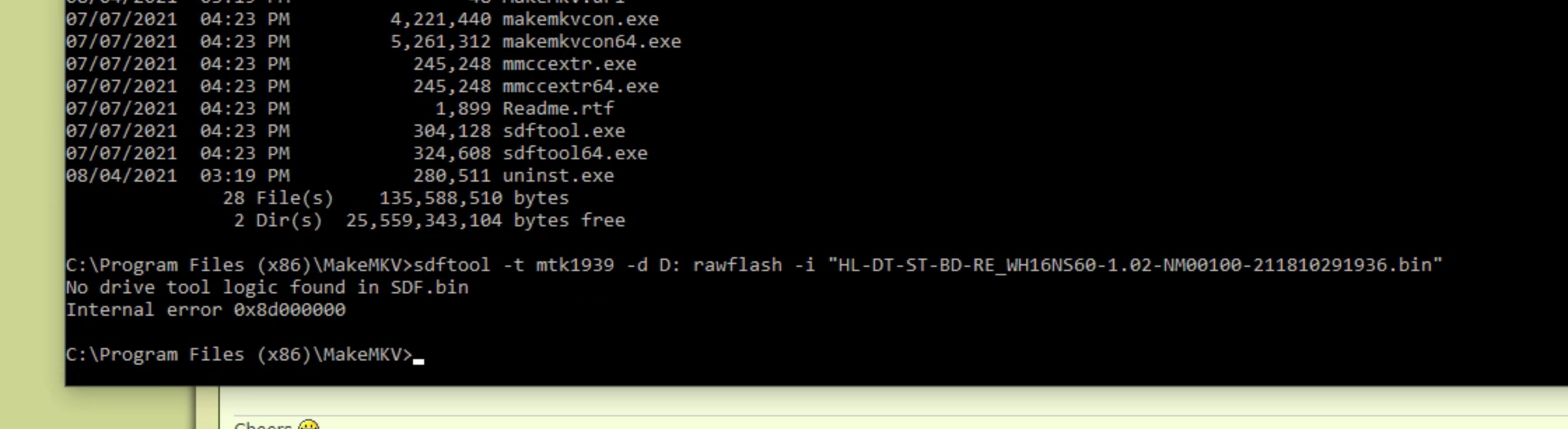

Coopervid wrote: Fri Aug 20, 2021 10:11 pm First flash 1.05 MK with enc. Then downgrade to whatever you want.
After that don't check enc anymore.
That did not work.

MartyMcNuts wrote: Sat Aug 21, 2021 1:14 am
SteelBookCollector wrote: Fri Aug 20, 2021 1:47 pm Got a brand new WH16NS40 with 1.05 Firmware.
SDFTool v1.2.0, trying to flash to WH16NS60 v1.02 from the old folder, check the enc box.
Getting error code 0x8f056103
On Windows 10 X64. dotNet newer then 4.7.2
What am I doing wrong?
How is your drive connected?
Do you have MakeMKV 1.15.1 or above instlled?
Drive connected directly via SATA,
MakeMKD 1.16.4 installed

Billycar11 wrote: Sat Aug 21, 2021 12:41 am
that should have worked try the command line.
Screen Shot 2021-08-23 at 4.43.35 PM.png (725.33 KiB) Viewed 38445 times
Posts: 6017
Re: SDFtool Flasher
SteelBookCollector wrote: Mon Aug 23, 2021 8:46 pm
open a bluray in makemkv then try again and make sure allow server updates is on
Posts: 4645
Re: SDFtool Flasher
Your command line includes -mtk1939 but this drive uses the 1959 chip.
