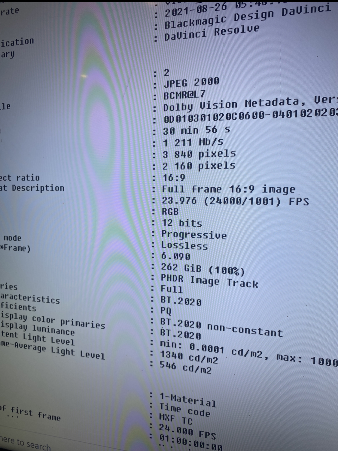

Manixx2020beyound wrote: Wed Aug 25, 2021 7:40 pm Waiting patiently for 4.0
2.9 does not use the resolve dv analysis tool.
The test build should now at least parse v4.0 properly. https://github.com/quietvoid/dovi_tool/ ... -906094633
I don't have enough samples to confirm if L3 is correct nor to add anything more (other than possibly automatically calculated L4).
Post by Manixx2020beyound » Thu Aug 26, 2021 5:15 am
quietvoid wrote: Thu Aug 26, 2021 5:00 am
Thank you, again much appreciated!
Works like a charm,
Once 4.0xml is parsed
I have 2 choices encode from the Master with Rpu/ encode raw with Rpu both work .
Just brilliant!

Good to know.
It's a little weird to see L2 stronger adjustments for 1000 nits but less for 600. Only you would know if it's correct though.
The trim_slope (Gain) is still possibly wrong, since I couldn't match the values all the time with the samples I have.

What’s great about this tool even if u have a Dolbyvision license u are now able to view your work before it goes mainstream in doblyvision with all the trims well, almost all the trims.
No one can view their workflow in dv well only using rgb tunneling but that’s it u have no acess to your doblyvision created content
Hdr10/sdr only for playback now we have it all.
