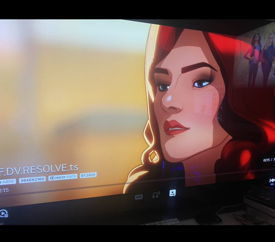

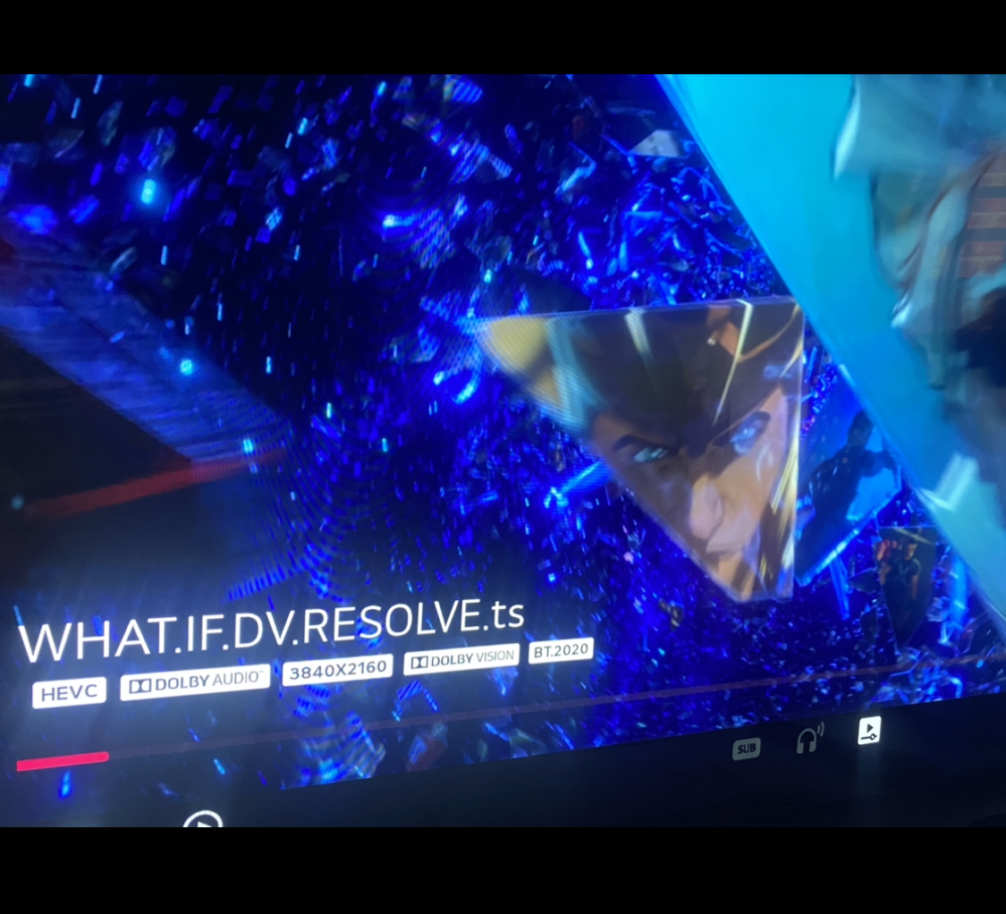

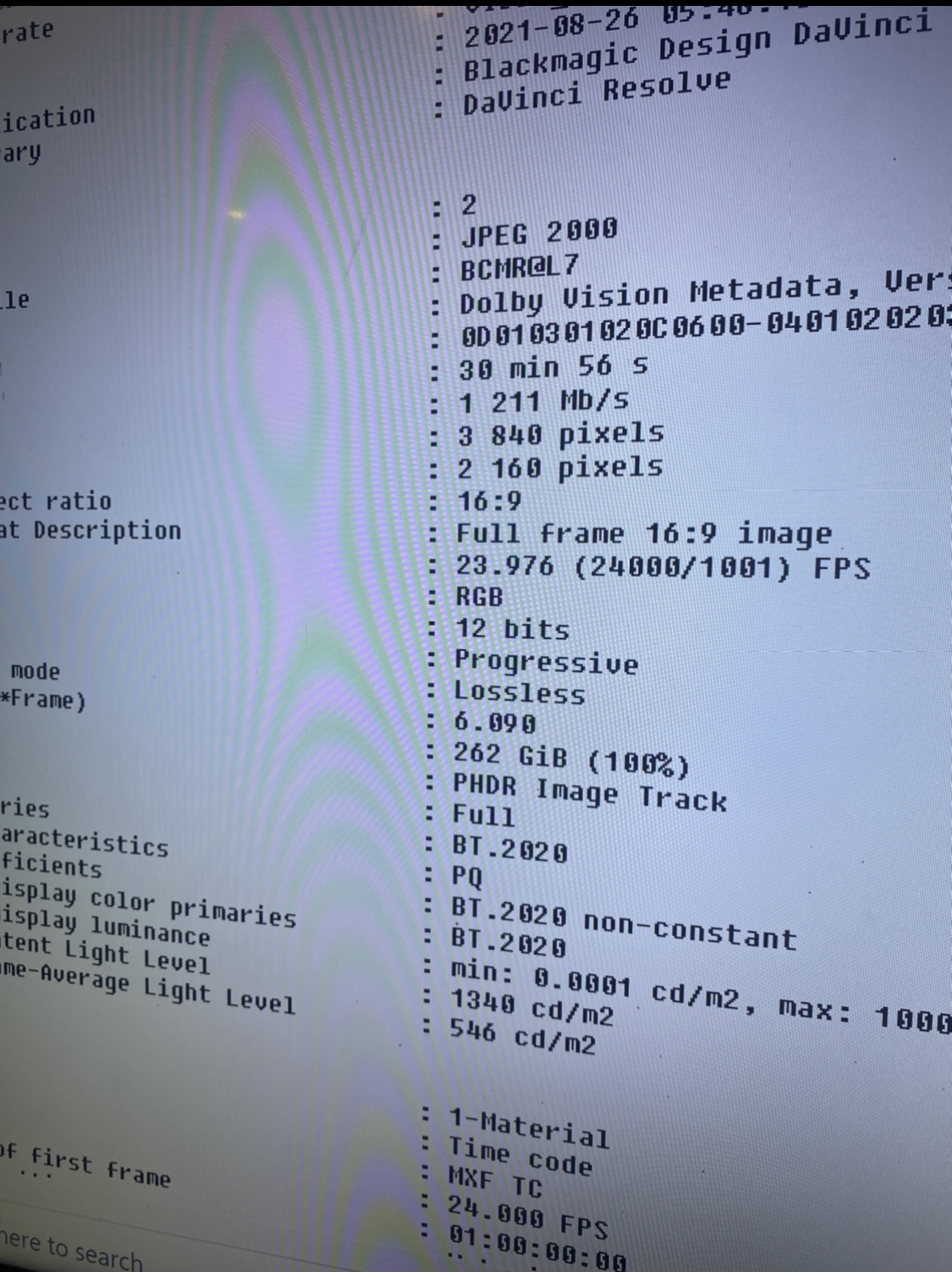

Manixx2020beyound wrote: Wed Aug 25, 2021 7:40 pm Waiting patiently for 4.0
2.9 does not use the resolve dv analysis tool.
The test build should now at least parse v4.0 properly. https://github.com/quietvoid/dovi_tool/ ... -906094633
I don't have enough samples to confirm if L3 is correct nor to add anything more (other than possibly automatically calculated L4).
#5389 Post by Manixx2020beyound » Thu Aug 26, 2021 5:15 am
quietvoid wrote: Thu Aug 26, 2021 5:00 am
Thank you, again much appreciated!
Works like a charm,
Once 4.0xml is parsed
I have 2 choices encode from the Master with Rpu/ encode raw with Rpu both work .
Just brilliant!
