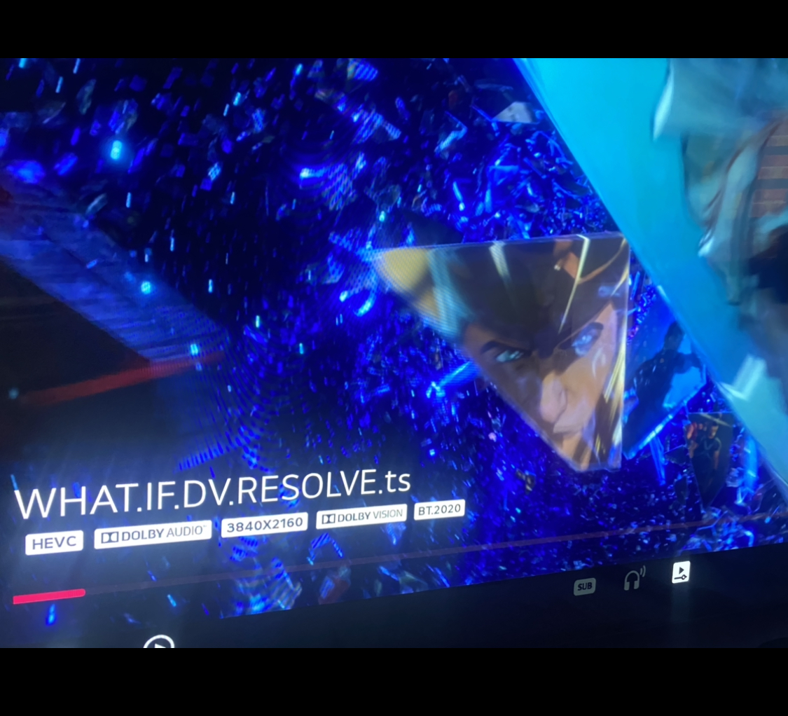

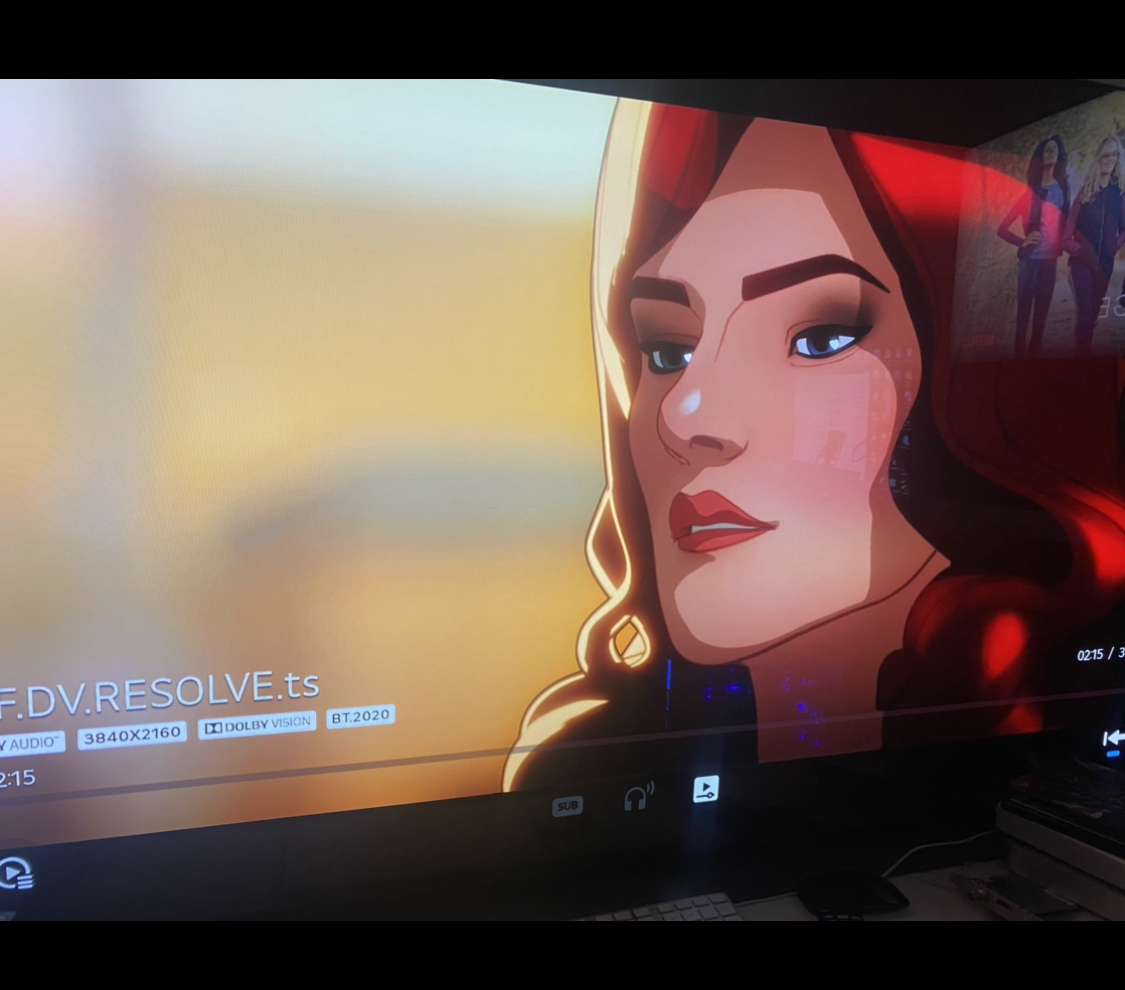

Raw footage:
Now I can create a dv music video
With l1
Testing a dv/hdr10plus xml master of beckett which also has secondary trims too
Created by resolve
For raw footage we should be able to define the aspect ratio in the final encoding settings
