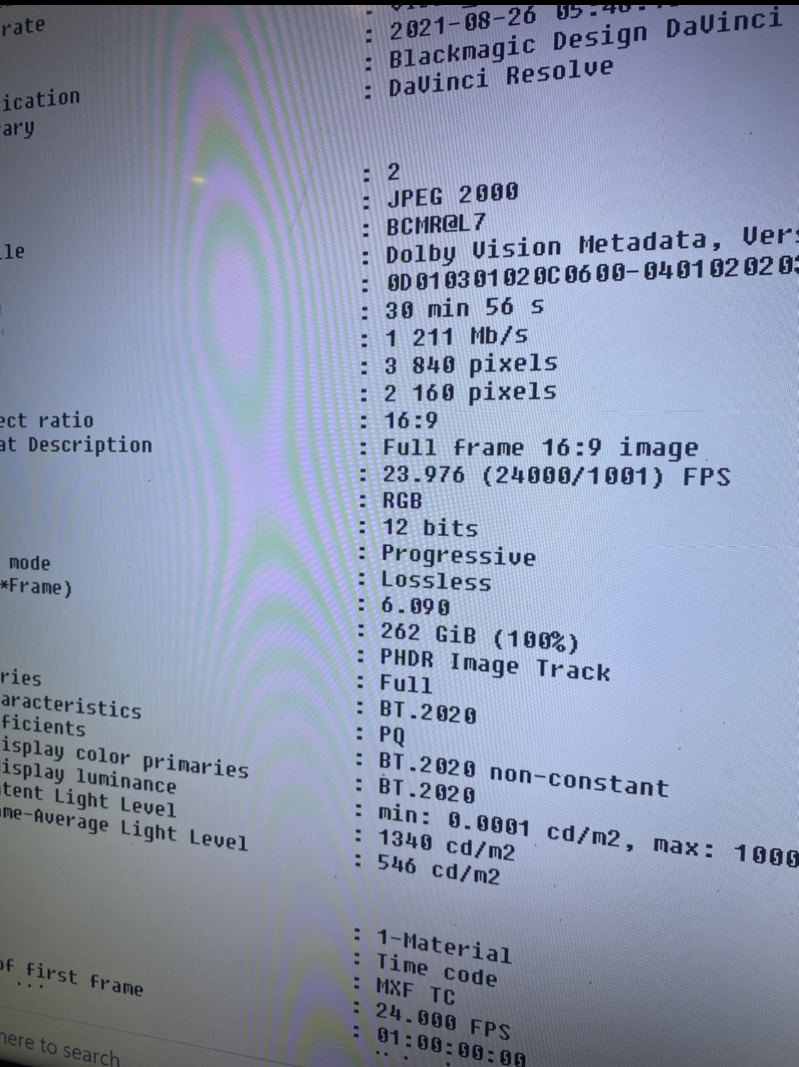

Once 4.0xml is parsed
I have 2 choices encode from the Master with Rpu/ encode raw with Rpu both work .
Just brilliant!

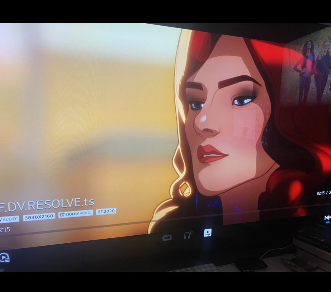

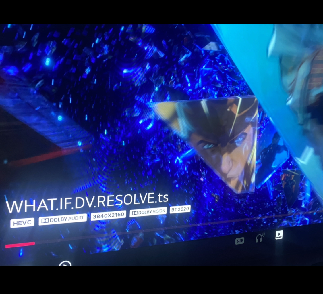

Quick test sample works
Possibilities are now endless
What’s great about this tool even if u have a Dolbyvision license u are now able to view your work before it goes mainstream in doblyvision with all the trims well, almost all the trims.
No one can view their workflow in dv well only using rgb tunneling but that’s it u have no acess to your doblyvision created content
Hdr10/sdr only for playback now we have it all.
