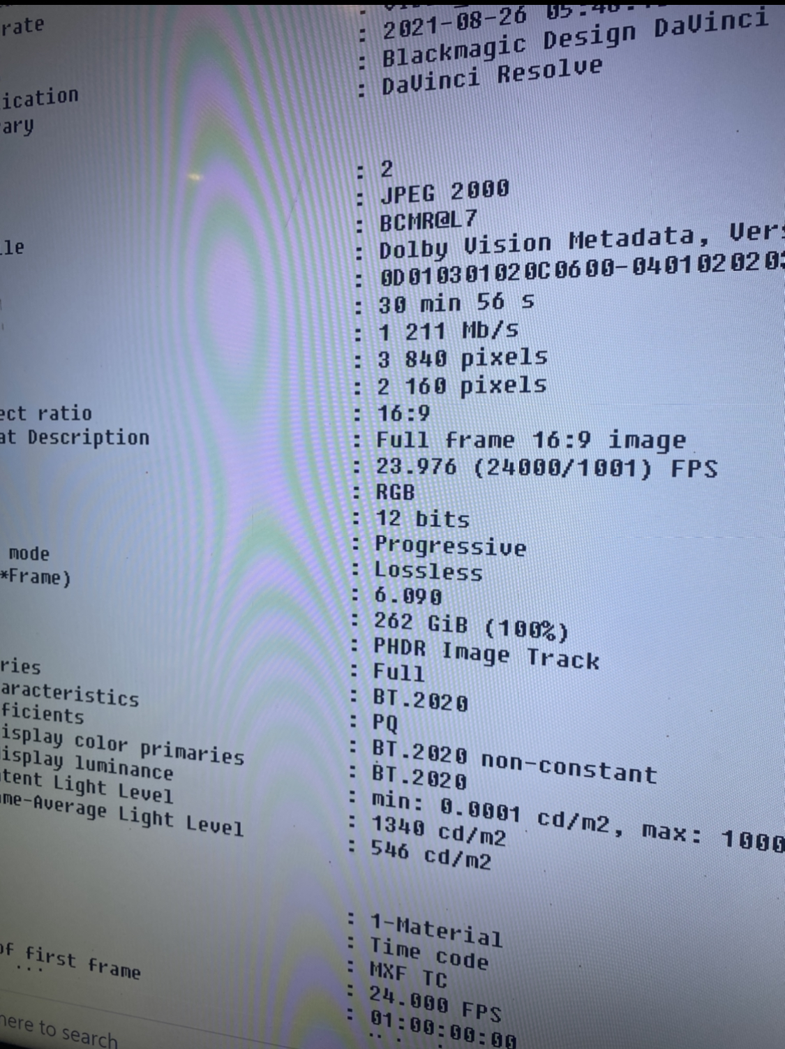

Raw footage:
Now I can create a dv music video
With l1
Testing a dv/hdr10plus xml master of beckett which also has secondary trims too
Created by resolve
For raw footage we should be able to define the aspect ratio in the final encoding settings

“NO BANZ TO MAKE DV DANCE”
Raw footage:
With l1
Created by resolve
By the way, currently it only works for CMv2.9 XML files. Will look at supporting v4.0 but things like secondary trims are not backwards compatible.
