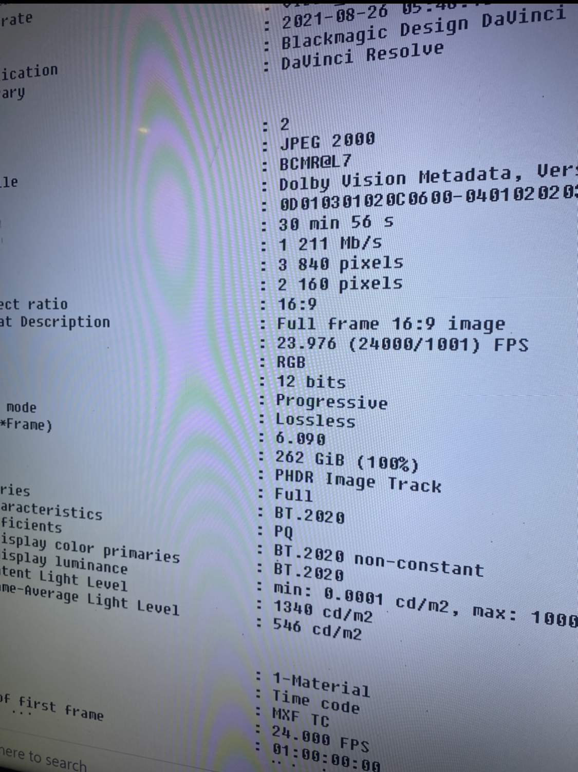

Post by Manixx2020beyound » Wed Aug 25, 2021 7:40 pm
quietvoid wrote:
Wed Aug 25, 2021 7:08 pm
Manixx2020beyound wrote:
Wed Aug 25, 2021 2:22 pm
Fantastic! great news!!
Thanks, so much will be testing tonight.
“NO BANZ TO MAKE DV DANCE”
Raw footage:
Now I can create a dv music video
With l1
Testing a dv/hdr10plus xml master of beckett which also has secondary trims too
Created by resolve
For raw footage we should be able to define the aspect ratio in the final encoding settings
By the way, currently it only works for CMv2.9 XML files. Will look at supporting v4.0 but things like secondary trims are not backwards compatible.
Waiting patiently for 4.0
2.9 does not use the resolve dv analysis tool.

Post by higher » Thu Aug 26, 2021 2:31 pm
Sorry for asking this but is there a way to mux or convert Dolby Vision mkv's to mp4? Unfortunately LG OLED TV's built-in players are not recognizing DV in the mkv container and I don't have an X700 or Shield 2019. Excuse me if it had been asked earlier.
Keep up the great work!
quietvoid
Posts: 377
Post by quietvoid » Thu Aug 26, 2021 4:09 pm
Thu Aug 26, 2021 5:15 am
Thank you, again much appreciated!
Works like a charm,
Once 4.0xml is parsed
I have 2 choices encode from the Master with Rpu/ encode raw with Rpu both work .
Just brilliant!
Good to know.
It's a little weird to see L2 stronger adjustments for 1000 nits but less for 600. Only you would know if it's correct though.
The trim_slope (Gain) is still possibly wrong, since I couldn't match the values all the time with the samples I have.
Post by Manixx2020beyound » Thu Aug 26, 2021 5:02 pm
Works like a charm,
Just brilliant!
Good to know.
Quick test sample works
Possibilities are now endless
What’s great about this tool even if u have a Dolbyvision license u are now able to view your work before it goes mainstream in doblyvision with all the trims well, almost all the trims.
No one can view their workflow in dv well only using rgb tunneling but that’s it u have no acess to your doblyvision created content
Hdr10/sdr only for playback now we have it all.
