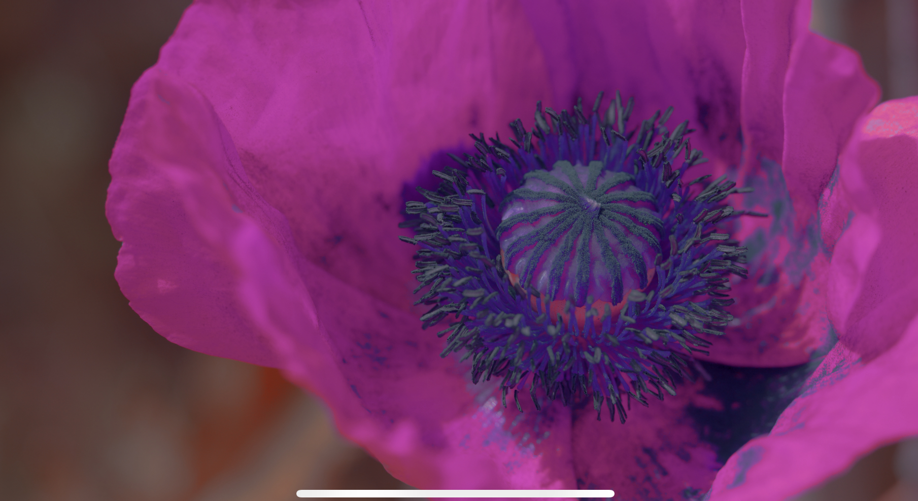

Ah, I see what you mean. I didn't realise that the RPU data includes which profile it is for. So it's actually reasonable that Infuse would ignore the RPU in my hacked-together file because it's for the wrong profile. So we don't have any evidence that Infuse is playing profile 5 files incorrectly. I'll keep investigating. Thanks again for all your help!

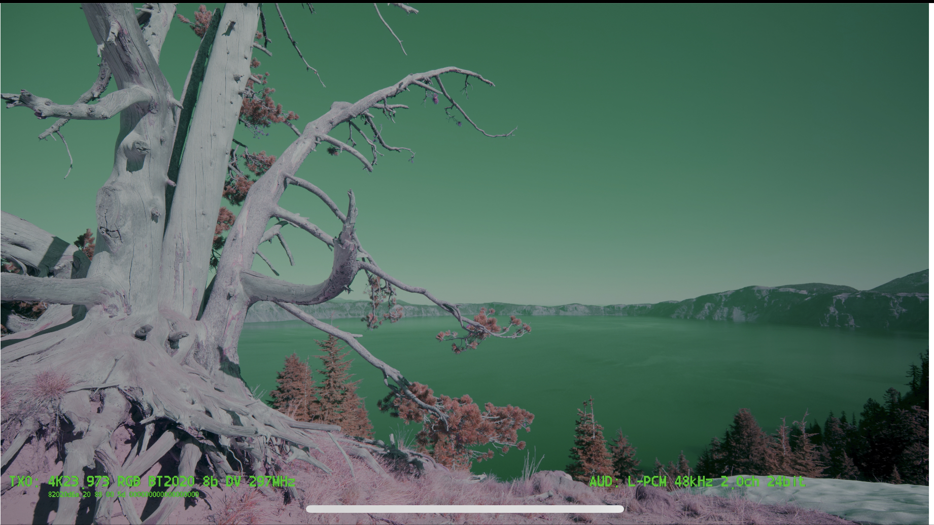

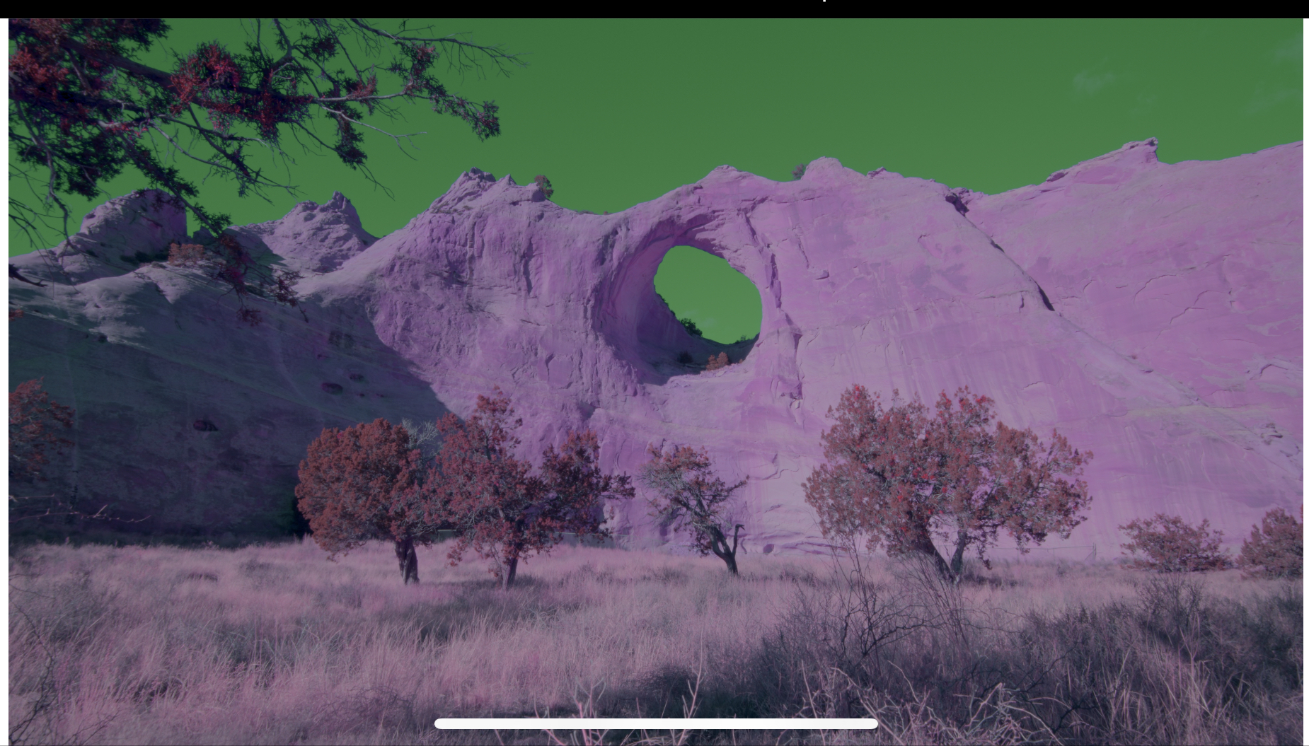

Post by FubbAyH » Mon Aug 23, 2021 1:56 am
(Sorry if I'm boring anyone to tears with this saga, I'll shut up soon.)
I've now found a profile 5 RPU and have injected that into my test file and it also seems to be ignored when playing back in Infuse (and in Plex). My (LG B7 OLED) TV's built-in video player gives dramatic color changes when playing the test file so it appears to be processing the RPU correctly. I've sent the sample and a video of the LG's playback to the Infuse developers, and I'll report back if they reply.

Post by RESET_9999 » Mon Aug 23, 2021 2:51 am
nah keep going, this thread is all about experimenting with DV.
in order to properly test if rpu is used, you probably should modify/unsync a true p5 file instead of injecting a p5 rpu to a random HDR10 BL.
You can delay the rpu metadata with a JSON edit and inject it back into the original p5 bl and it should produce visible brightness changes. the file would still follow dv specs.
this json will delay the metadata 120frames.

Post by FubbAyH » Mon Aug 23, 2021 3:50 am
glc650 wrote:
Mon Aug 23, 2021 2:41 am
Please don't..if it really is ignoring RPU appreciate the work getting it fixed.
I'll probably have to wait until next weekend to do any more experiments, but thanks very much for the encouragement :)
