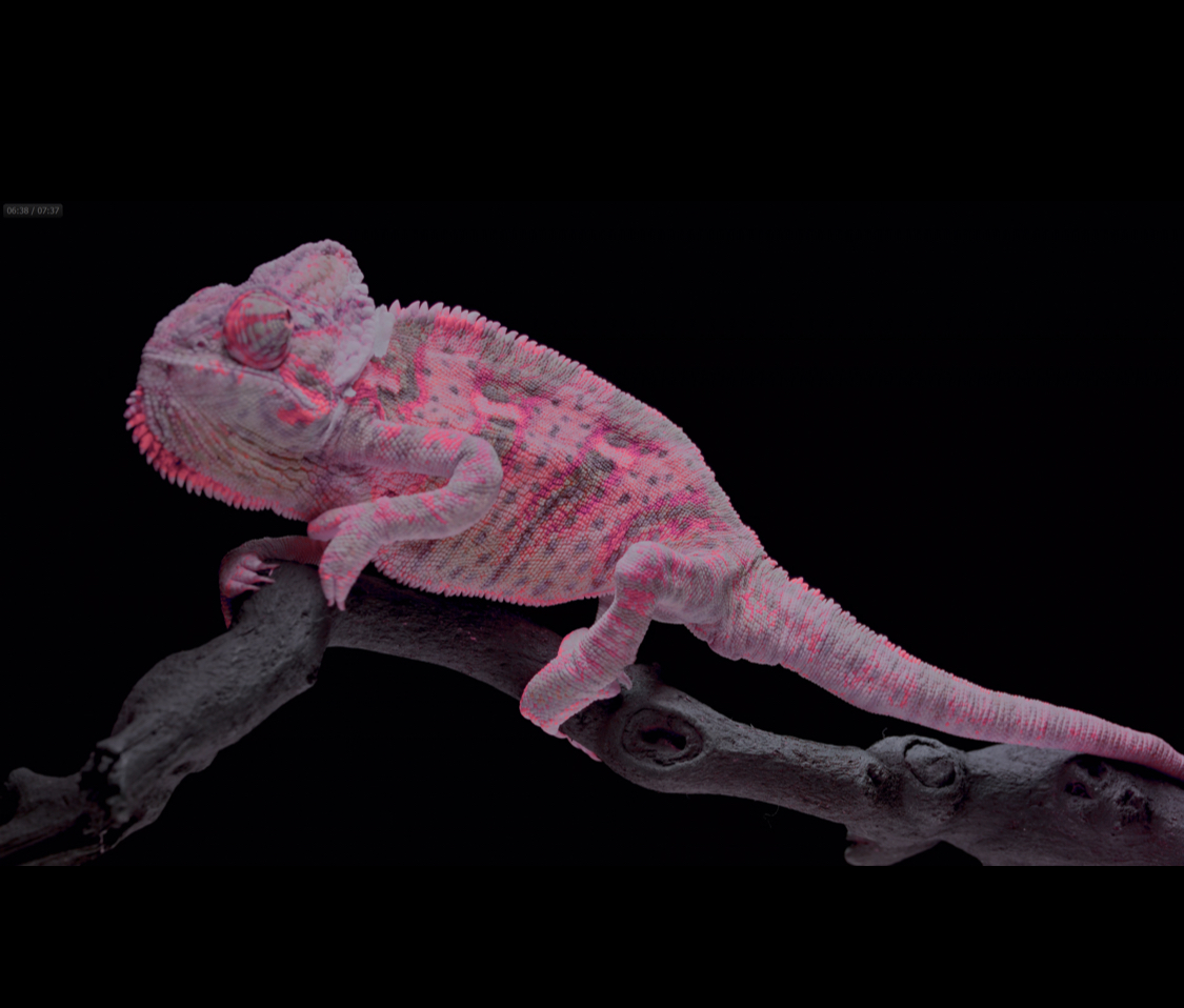

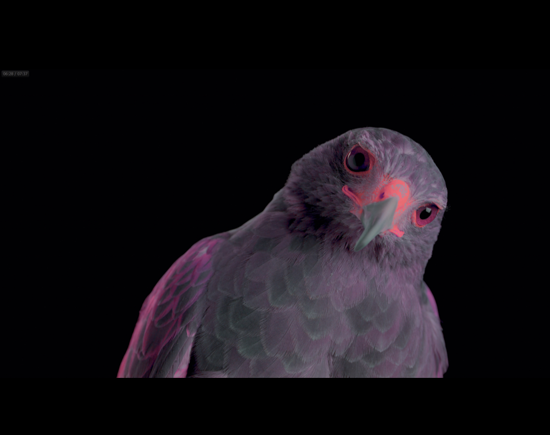

mulucy wrote: Thu Jul 22, 2021 11:54 pm I am not sure what the deal is. But my Apple TV 4K ( the previous Gen ) plays P7 MEL and P8 with Plex. What's interesting is, Plex plays P5 files with messed-up green or purple colors lol. Infuse Pro falls back to HDR10 with all profiles, but P5. Anybody knows what's happening, is it Plex magic or has Apple added more support via software update?
Plex on Apple TV does some fakery unfortunately, so it isn't real profile 7 or profile 8 support. It switches the TV to DV mode, but is actually just playing the HDR10 version.
