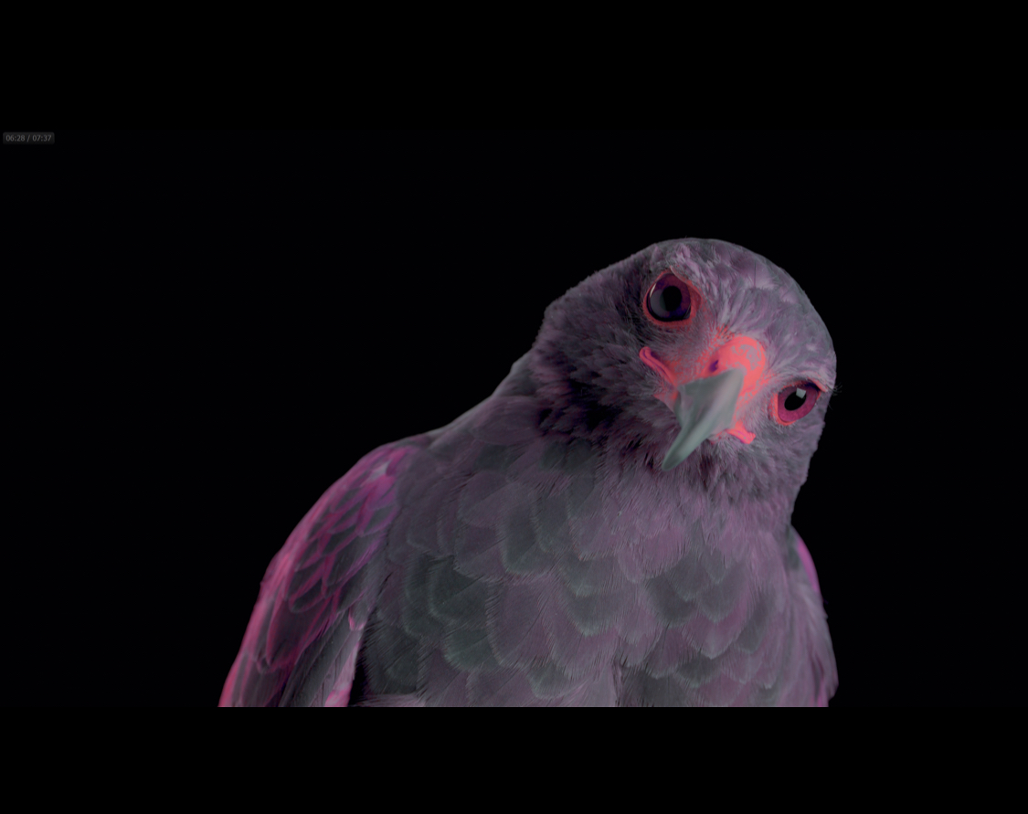

RGB/DV/8b so that beak should be better than LLDVFubbAyH wrote: Sat Aug 21, 2021 8:19 pm I noticed that x265 can do Dolby Vision encoding now, and I'm thinking about transcoding my DV UHDBD rips to profile 5 so that they're playable with DV on my beloved Apple TV. I used to think transcoding was sacrilege, but I've softened in my old age and am now thinking that if I throw enough CPU time and bitrate allowance at the encode then hopefully it will be indistinguishable from the source, and if it gives a better experience overall (for me) then it might be worth it.

- F0E45BB3-2A6F-4978-B55C-3B0DEECB18C3.jpeg (523.87 KiB) Viewed 22583 times
- 5B05CDF8-28CB-4BCC-B054-AE4B25C243DB.jpeg (404.25 KiB) Viewed 22583 times
