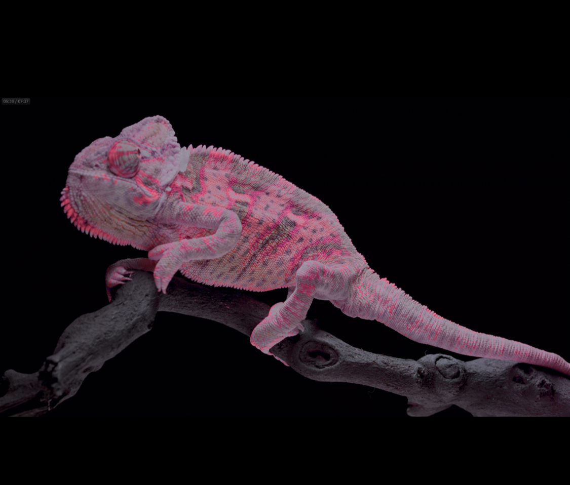

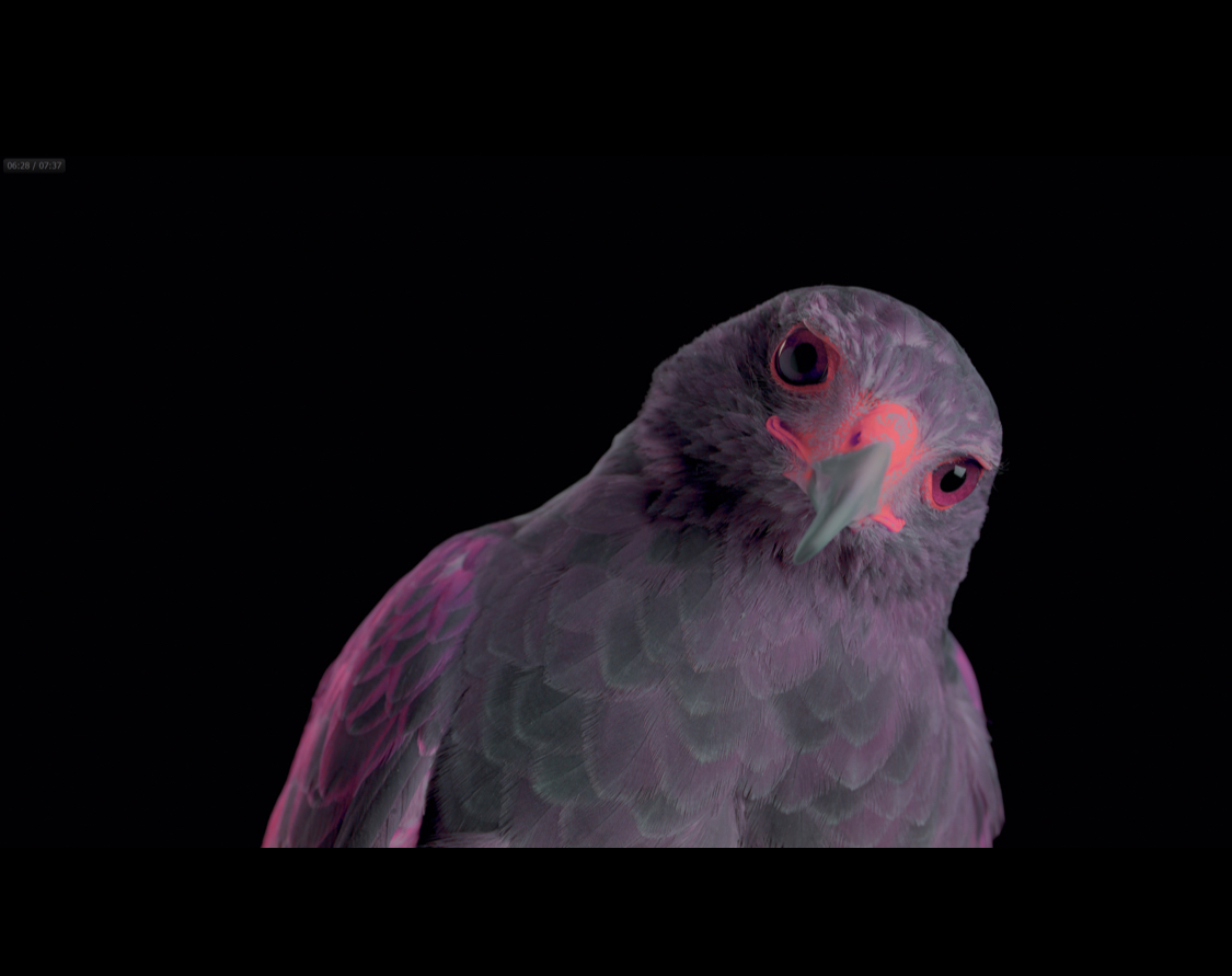

I have noticed weird color issues with online P5 files, mainly from HBO Max and Disney Plus. On Apple TV 4k 1st Gen with Infuse/Plex or my built-in TV apps using USB files, I have these green, purple, and sometimes red color issues. I have two Apple TV 4ks, tested on my Vizio and TCL. But Fire TV 4k Stick has been super stable and rock-solid, with no issues so far. I have had some problems with P5 DV titles in the MP4 container, mainly was related to freezing. I am assuming it has nothing to do with Fire TV itself. There is something wrong with MP4 encoding ( I am at least assuming ).
