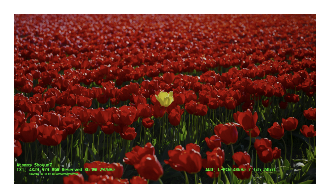

#5269 Post by Manixx2020beyound » Tue Aug 03, 2021 5:19 pm
lexyz wrote: Tue Aug 03, 2021 9:09 am
RESET_9999 wrote: Sun Aug 01, 2021 2:36 am @lexyz and @ragico . How does it look on your TVs?
Will check next weekend
The best players for lossless DV rips are still the oppo and the x700 (or x800m2).
Both have LLDV issues
Oppo is inaccurate in DV output after HDR10 playback.
X700 can't auto switch to DV
Sadly, any DV-capable device has issues
Well some comparison news:
We can now compare RGB 8bit DV so we don’t need to do (LLDV/bug,)
Still a few more tests to come.
Bypassing the pink screen in rgb 8 dv
This clip is from the x700.

Sorry for a silly question, but I see "RGB 8bit DV " and 12-bit something referred a lot here with TV-Led and LLDV, would you mind telling the difference, please?

mulucy wrote: Tue Aug 03, 2021 7:14 pm Sorry for a silly question, but I see "RGB 8bit DV " and 12-bit something referred a lot here with TV-Led and LLDV, would you mind telling the difference, please?
LLDV / player-led : it's the player doing the tonemapping which is buggy. It's sending a decoded 422 12bits signal (decoded so thats why we can capture it)
RGB 8bit tunneling/ tv-led: it's the TV doing the tonemapping which is accurate. it's still sending 422 12bits but wrapped in an 8bit RGB container. ( @manix thinks he found how to capture it but i don't believe him)
