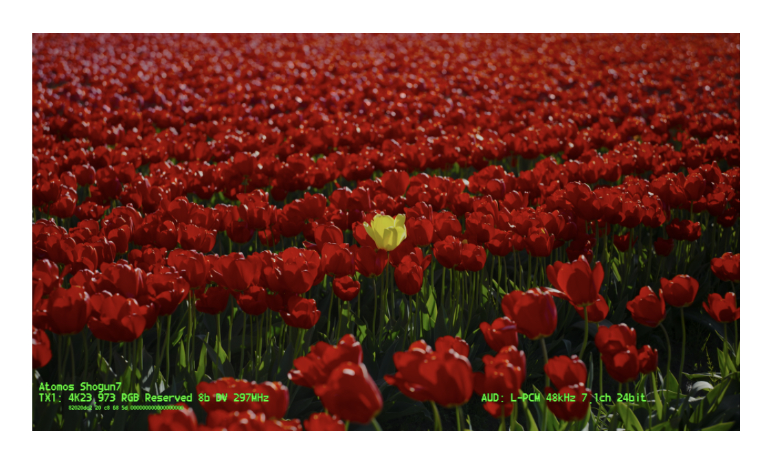

Well some comparison news:
We can now compare RGB 8bit DV so we don’t need to do (LLDV/bug,)
Still a few more tests to come.
Bypassing the pink screen in rgb 8 dv
This clip is from the x700.

Sorry for a silly question, but I see "RGB 8bit DV " and 12-bit something referred a lot here with TV-Led and LLDV, would you mind telling the difference, please?

mulucy wrote: Tue Aug 03, 2021 7:14 pm Sorry for a silly question, but I see "RGB 8bit DV " and 12-bit something referred a lot here with TV-Led and LLDV, would you mind telling the difference, please?
LLDV / player-led : it's the player doing the tonemapping which is buggy. It's sending a decoded 422 12bits signal (decoded so thats why we can capture it)
RGB 8bit tunneling/ tv-led: it's the TV doing the tonemapping which is accurate. it's still sending 422 12bits but wrapped in an 8bit RGB container. ( @manix thinks he found how to capture it but i don't believe him)
thank you so much!
