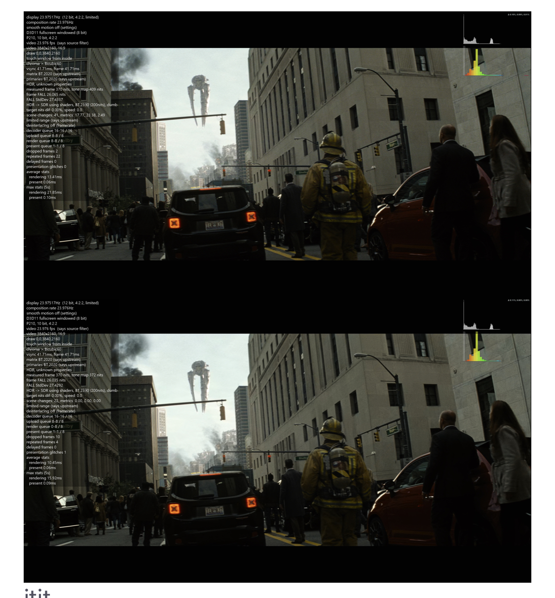

#5195 Post by Manixx2020beyound » Sun Jul 25, 2021 6:40 pm
Bat vs sup p8 vs p5
Bat vs sup p8 vs p5
Looks very close almost identical
Uploading test files

#5197 Post by RESET_9999 » Sun Jul 25, 2021 8:22 pm
Manixx2020beyound wrote: Sun Jul 25, 2021 6:40 pm Looks very close almost identical
looks like you have madVR dynamic clipping active for those pictures manix ...
this frame is interesting though. You can see a small green tint on the building that clearly comes from the HBO p5 (or manix dv to hdr10 settings).
p5 vs p8 vs HDR10 HBO vs HDR10 bluray:
https://slow.pics/c/lTiFdsxj
https://slow.pics/c/IoBZjQMN

p5 vs P8 vs HDR10
Mulan:
https://slow.pics/c/uxKywJ6r
https://slow.pics/c/WWu8Ysik
https://slow.pics/c/ar5Wqvqe
Onward:
https://slow.pics/c/W0fnx5TO
https://slow.pics/c/EtaiU1SV
https://slow.pics/c/PrePMVac
AppleTV+ home before dark (ignore the grey-black bars caused by the x700 with cropped content):
https://slow.pics/c/bs569a22
https://slow.pics/c/Ny8jC6GR
https://slow.pics/c/CapqIJlx
for fun, home before dark DV p5 tonemapped to SDR with movies and tv app win10 compared to madvr hdr to sdr:
https://screenshotcomparison.com/comparison/16129
AppleTV+ ted lasso:
https://slow.pics/c/8nVLCFVq
https://slow.pics/c/H6xrVpNu
https://slow.pics/c/CtyxwrRU
Batman v superman:
Star Wars new hope:
https://slow.pics/c/Nd423gGO
https://slow.pics/c/qA4L4HUk
https://slow.pics/c/cKSjjNSD
https://slow.pics/c/jKrPq1Vf
Image Image
