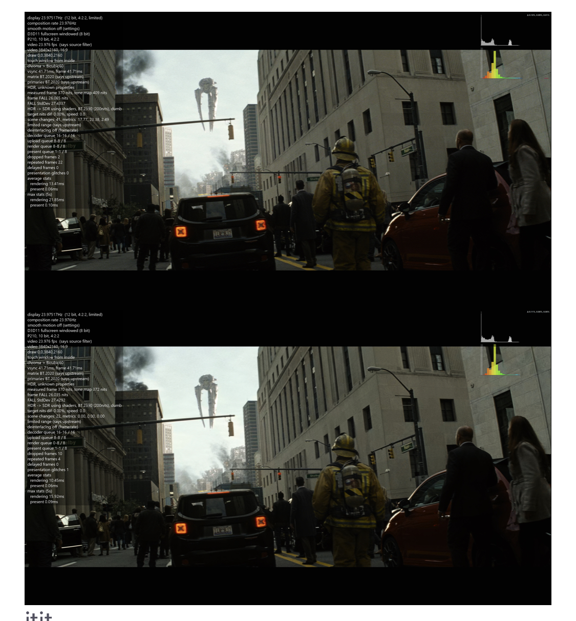

Post by Manixx2020beyound »
Bat vs sup p8 vs p5
Bat vs sup p8 vs p5
Looks very close almost identical

Manixx2020beyound wrote: Sun Jul 25, 2021 6:40 pm Looks very close almost identical
Uploading test files
looks like you have madVR dynamic clipping active for those pictures manix ...
this frame is interesting though. You can see a small green tint on the building that clearly comes from the HBO p5 (or manix dv to hdr10 settings).
p5 vs p8 vs HDR10 HBO vs HDR10 bluray:
