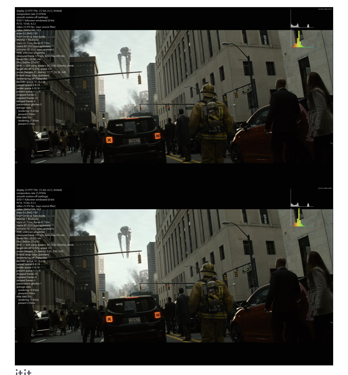

I got @manix(thank you) Atomos Shogun samples (LLDV stream captured in PQ then tonemapped to SDR with the same static madVR settings) ...
Star Wars P5 vs P8 vs HDR10 bluray:

Star Wars P5 and P8 look pretty much the same in DV but they are both different from HDR10.
Ted looks different in all samples, P8 is closer(but not the same) to HDR10.
I don't know what to think... He has to use the Dune Player for Ted samples because the x700 don't like cropped DV, so that could maybe explain the difference if the dune has issues with p5.
Post by shawnc22 » Sun Jul 25, 2021 2:04 am
In the case of Ted Lasso, are you just doing a straight P5 to P8 conversion? Then for star wars, you’re going throught the whole process of RPU extraction from P5 and applying it to the UHD HDR10 layer to get P8? If so, and I’m not sure if this has been asked already, but is quietvoid’s tool doing a colorspace conversion when going from P5 to P8? If not, that might be the reason why Ted Lasso looks so different. For the Star Wars scenario, it could be that the same RPU metadata can be applied to BL’s that’re in different colorspaces without issue.

both files are done the same way...
extract and convert rpu from profile 5 web-dl to p8 at the same time and then the rpu is injected into the HDR10 hevc stream.
the only difference is the player... but manix is doing the x700 sample even if the DV is cropped. The black bars will be grey but the rest should be fine
EDIT nop, its not the player...
p5 dune vs p5 x700 vs p8 dune vs p8x700: https://slow.pics/c/vuto1Dy6

It would be complicated to know if the HDR10 just has different chroma. That's pretty much the only difference I can see.
Would need a way to convert the DV ITP/IPT PQ colorspace into regular BT2020 PQ, but there's nothing public that does it all as far as I know.
Otherwise the only thing that comes to mind might be to change the min/max according to limited/full levels.
Since P5 is full, but the conversion doesn't change the numbers, only the flag.

Post by RESET_9999 » Sun Jul 25, 2021 4:48 am
one more comparison...
p5 vs p8 vs HDR10: https://slow.pics/c/e1ssuSEG
I thought maybe the LLDV bug was acting up here but nop, I get a similar difference in tv-led: https://screenshotcomparison.com/comparison/16090
here are the clips if you want to check them yourself:
https://drive.google.com/file/d/1Lh7zmo ... sp=sharing,
https://drive.google.com/file/d/1Oqkvmz ... sp=sharing
but as you say, hard to tell if its the source or the conversion

exactly the same static settings were used and dynamic tone mapping was disabled. the difference is NOT caused by madVR.. plus as i said, I'm seeing the same difference in tv-led...
PQ comparison, no madvr involved: https://slow.pics/c/qZ8YCaN2

also, it looks like the weird lines (ringing???)mostly in the blue are caused by profile 5 DV decoding because I can see them in TV-LED DV as well while the p8 DV is clean like HDR10.
they dont seem to be present in the p5 source:
p5 clip, no capture no tonemapping VS p8 capture , no tonemapping: https://slow.pics/c/x0YGLSYn
