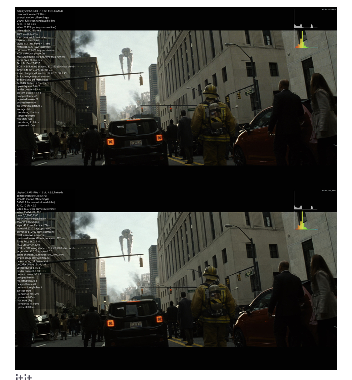

looks like you have madVR dynamic clipping active for those pictures manix ...
this frame is interesting though. You can see a small green tint on the building that clearly comes from the HBO p5 (or manix dv to hdr10 settings).
p5 vs p8 vs HDR10 HBO vs HDR10 bluray:
https://slow.pics/c/lTiFdsxj
https://slow.pics/c/IoBZjQMN
