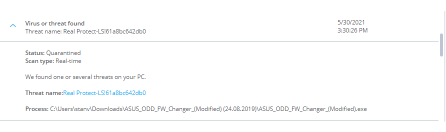

MartyMcNuts,
the ASUS_ODD_FW_Changer_(Modified).exe that is included in the ASUS_ODD_FW_Changer_(Modified) (24.08.2019).zip download is sequestered by up to date McAfeee Anti Virus when attempting to execute because McAfee AV detected a threat...
McAfee security report is attached...
has anyone else had this problem...
please advise...
Posts: 1716
#861 Post by d00zah » Mon May 31, 2021 7:18 pm
(Modified) ASUS ODD FW Changer (24.08.2019) + UHD Friendly Firmwares + Latest MK Pack (20.07.2020).zip: https://www.virustotal.com/gui/file/e3b ... /detection
ASUS_ODD_FW_Changer_(Modified).exe: https://www.virustotal.com/gui/file/57e ... /detection
Only 6 security vendors flagged this file as malicious (out of 69), probably because the tool modifies HW at a low (FW) level. File has been around since 2019, used by many & no bad reports (except, maybe, by people who didn't read ALL of the instructions).
