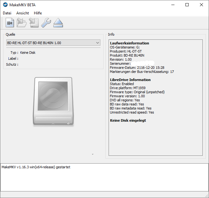

FlyByWire1
Joined: Fri Apr 09, 2021 9:21 pm
Re: SDFtool Flasher
Post by FlyByWire1 » Sat Apr 10, 2021 8:10 am
Screenshot 2021-04-10 100712.png (5.17 KiB) Viewed 36215 times
FlyByWire1
Re: SDFtool Flasher
Post by FlyByWire1 » Sat Apr 10, 2021 10:27 pm
Meanwhile, I made some progress. The drive was not an BU40N, but I found another one in my shelf that is an BU40N.
With the help og Billycar11 I installed fw DE 1.00.
Screenshot 2021-04-10 155626.png (38.33 KiB) Viewed 36197 times
Any DVD is still reporting an error.
Screenshot 2021-04-10 160612.png (4.02 KiB) Viewed 36197 times
Would it be wise to install MK fw 1.04? I could not find out what's best.
Extracting the movie to mkv with MakeMKV worked.
Posts: 4989
Re: SDFtool Flasher
Post by MartyMcNuts » Sun Apr 11, 2021 1:35 am
FlyByWire1 wrote: Sat Apr 10, 2021 10:27 pm Meanwhile, I made some progress. The drive was not an BU40N, but I found another one in my shelf that is an BU40N.
God no! 1.04 sucks. Stick with 1.00
