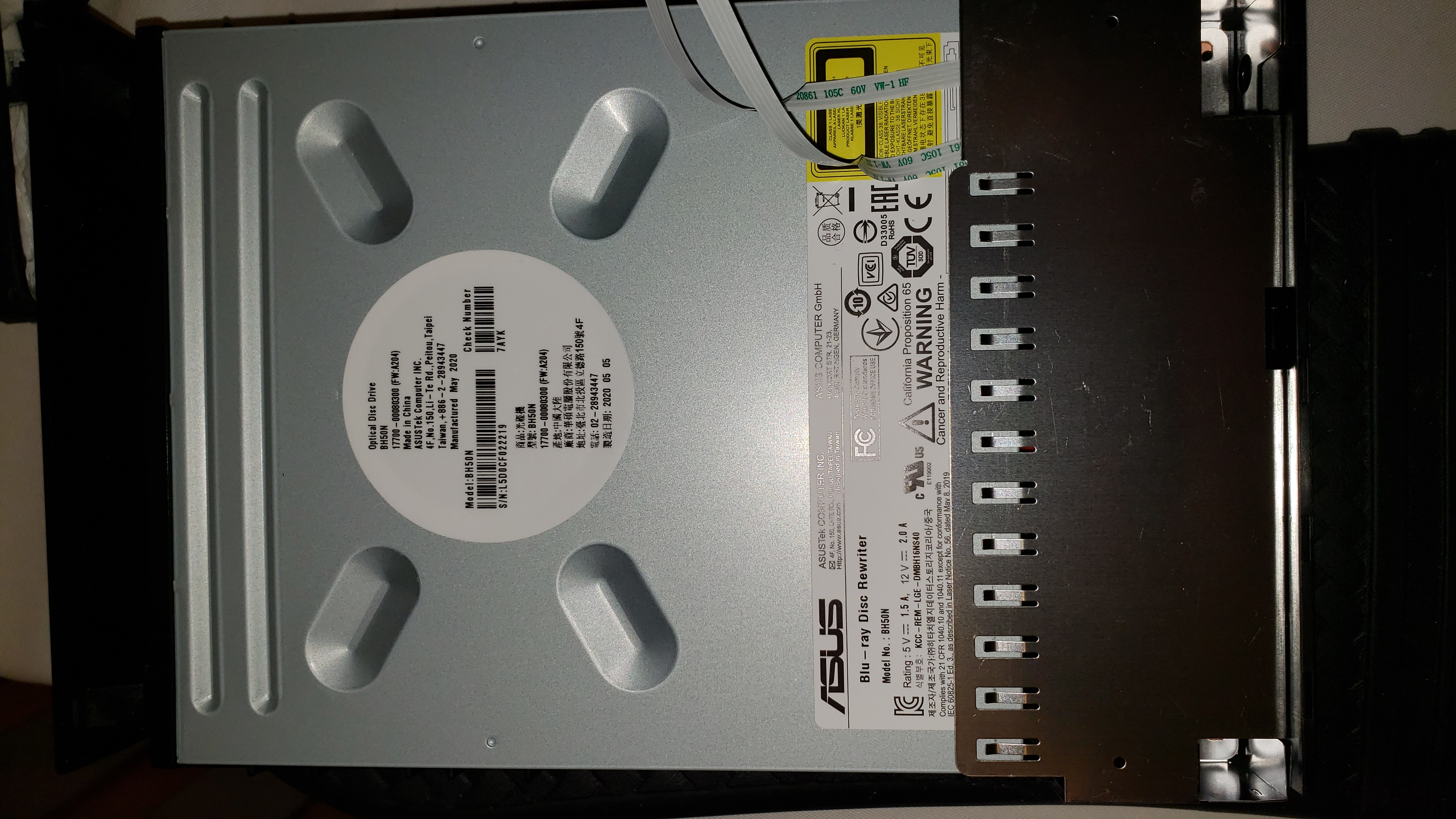

In the mean time I opened up my unit to confirm the hard drive model, and it is the BH50N (See attached image 2)
Posts: 6453
Re: Asus BW-16D1X-U
Post by Billycar11 » Mon May 03, 2021 4:37 am
yeah its the same as the W/BH16ns40 also the asus bw16
