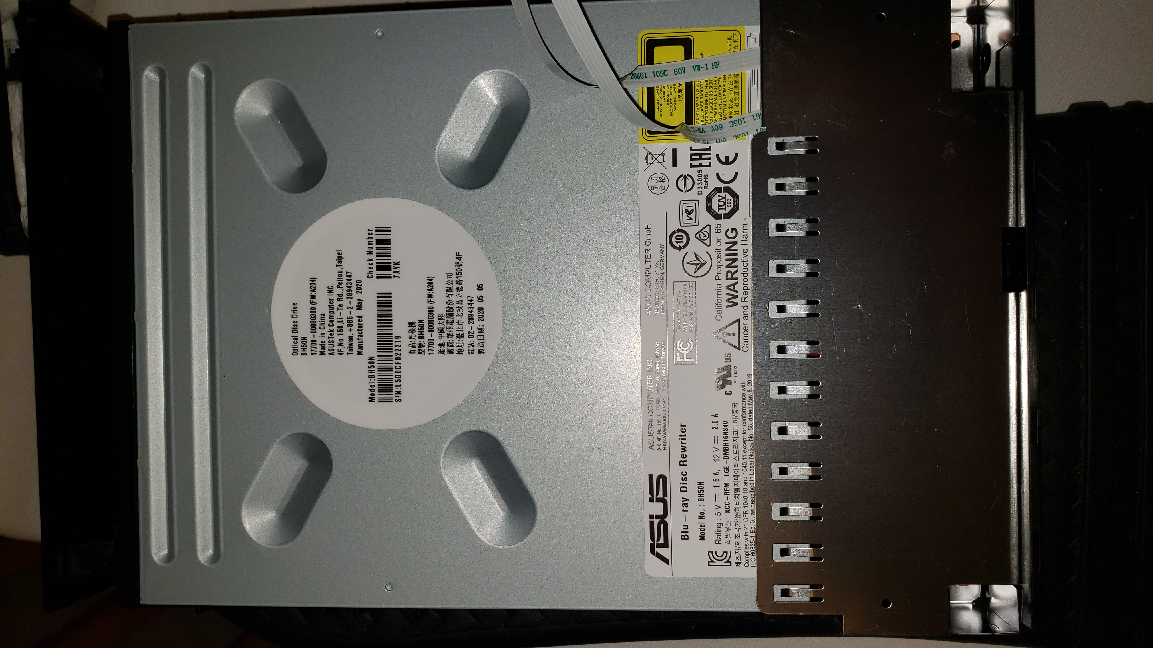

Re: Asus BW-16D1X-U
I just got an ASUS BW-16D1X-U. It appears my unit (see attached image 1) is similar to the one @KlatuVerataNikto successfully flashed:
...So I'm here now about to follow his footsteps but I'm not clear on what flashing tool he used...if someone wants to take this opportunity to document the steps for this device. I'd be happy to help...KlatuVerataNikto wrote: Tue Apr 06, 2021 4:14 pm I couldn't get the drive to flash on my Mac. Admittedly, I'm not great in terminal. Even copying and pasting the commands from the step by step thread did not work for me.
I busted out my old windows laptop running Windows 10. I downloaded and used the flashing tool. The flashing tool would not open unless I ran it as an administrator. The Asus firmware would not flash onto the drive. I ended up using the WH16NS60 1.02 firmware and it worked like a champ. Libre mode is enabled and I'm ripping 4K discs! Also, currently ripping Solo: A Star Wars Story with no problems!

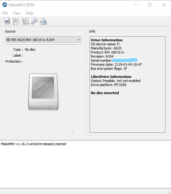

Re: Asus BW-16D1X-U
Thanks for response!
In the mean time I opened up my unit to confirm the hard drive model, and it is the BH50N (See attached image 2)
- Posts: 6301
Re: Asus BW-16D1X-U
yeah its the same as the W/BH16ns40 also the asus bw16
