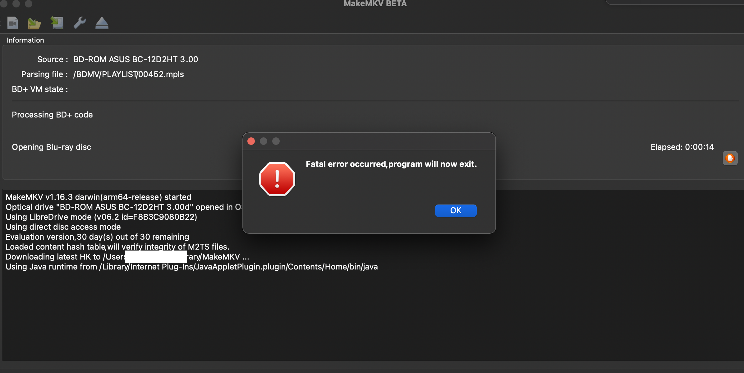

#192 Post by wurselum » Fri Apr 02, 2021 7:55 pm
Hey,
I have some problems to save my extended Version of "The Return of the King" german version part 2.
I got always a fatal error.
Is this a known error?
