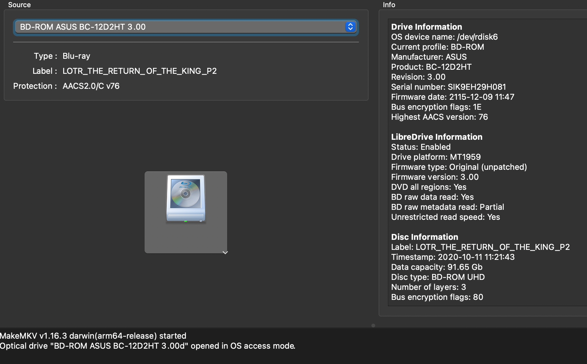

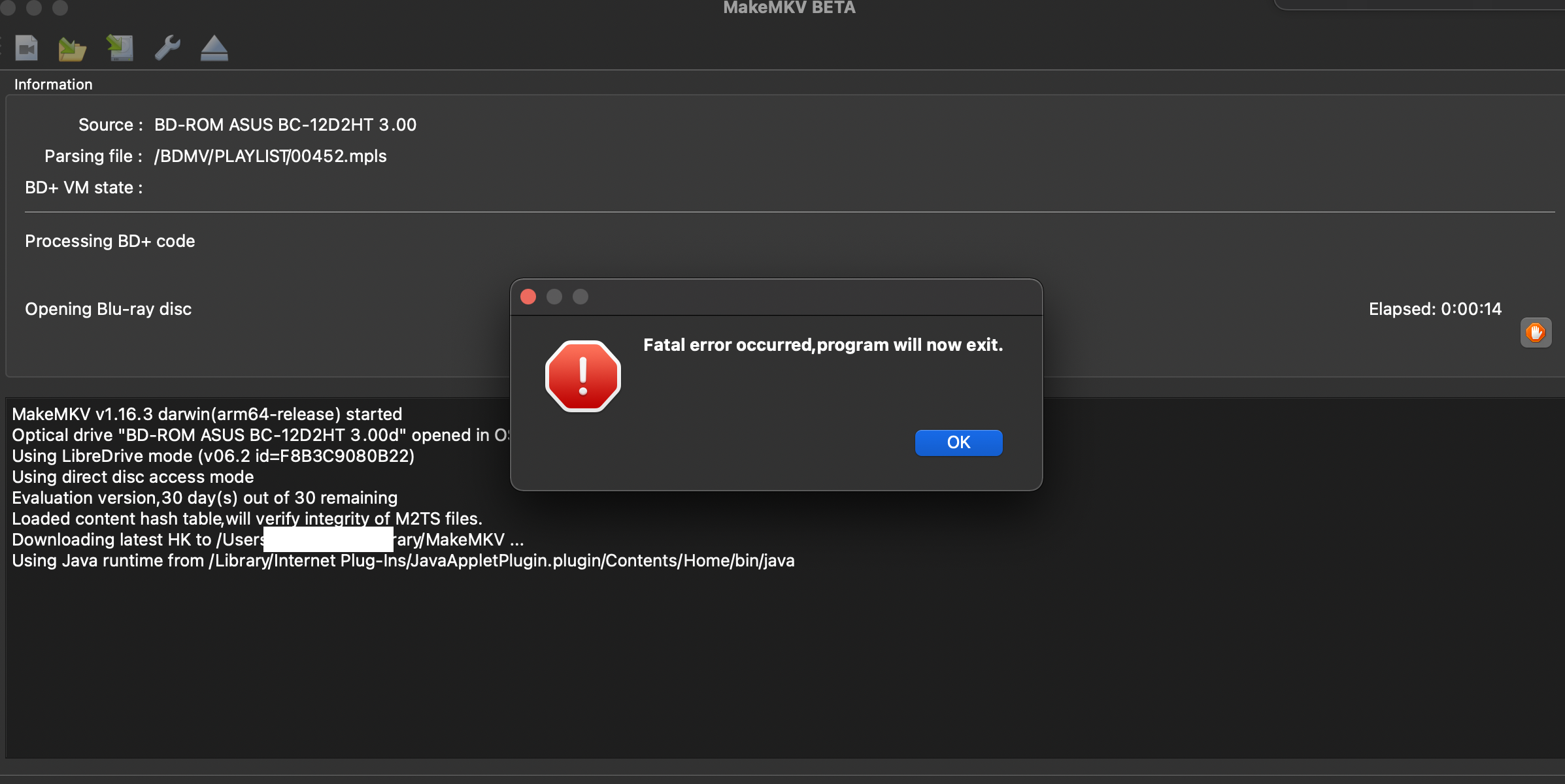

Hey,
I have some problems to save my extended Version of "The Return of the King" german version part 2.
I got always a fatal error.
Is this a known error?
Bildschirmfoto 2021-04-02 um 21.33.20.png (722.65 KiB) Viewed 42781 times
Bildschirmfoto 2021-04-02 um 21.34.12.png (683.35 KiB) Viewed 42782 times
