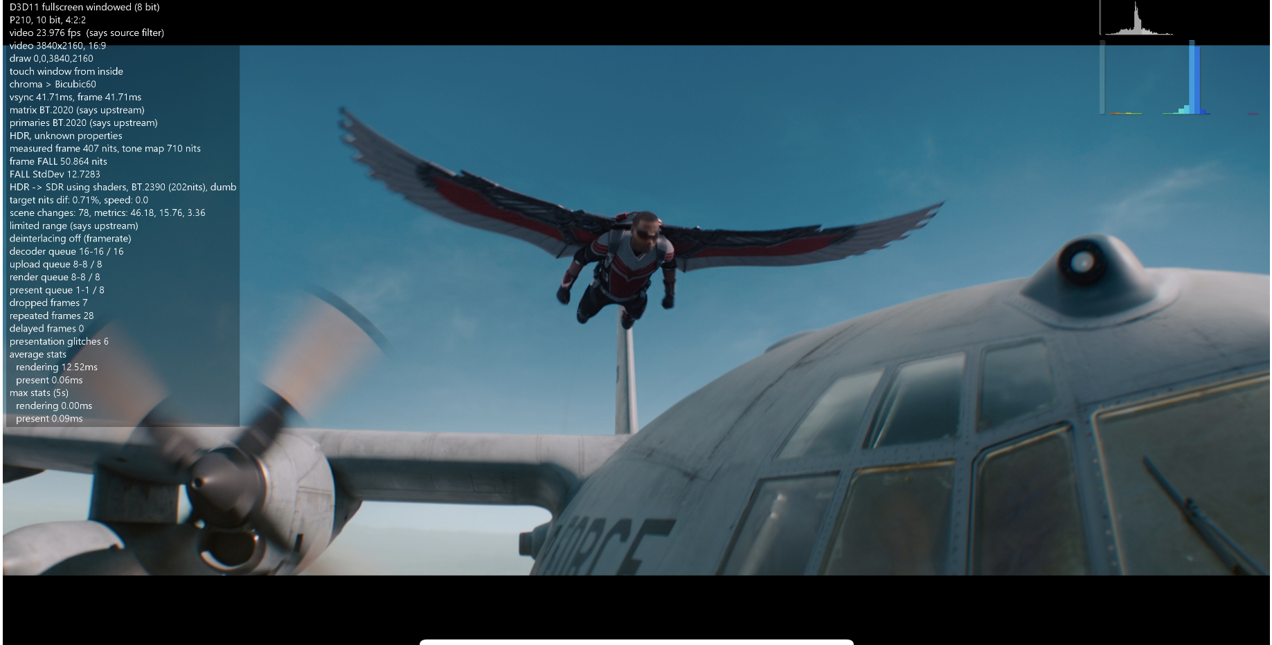

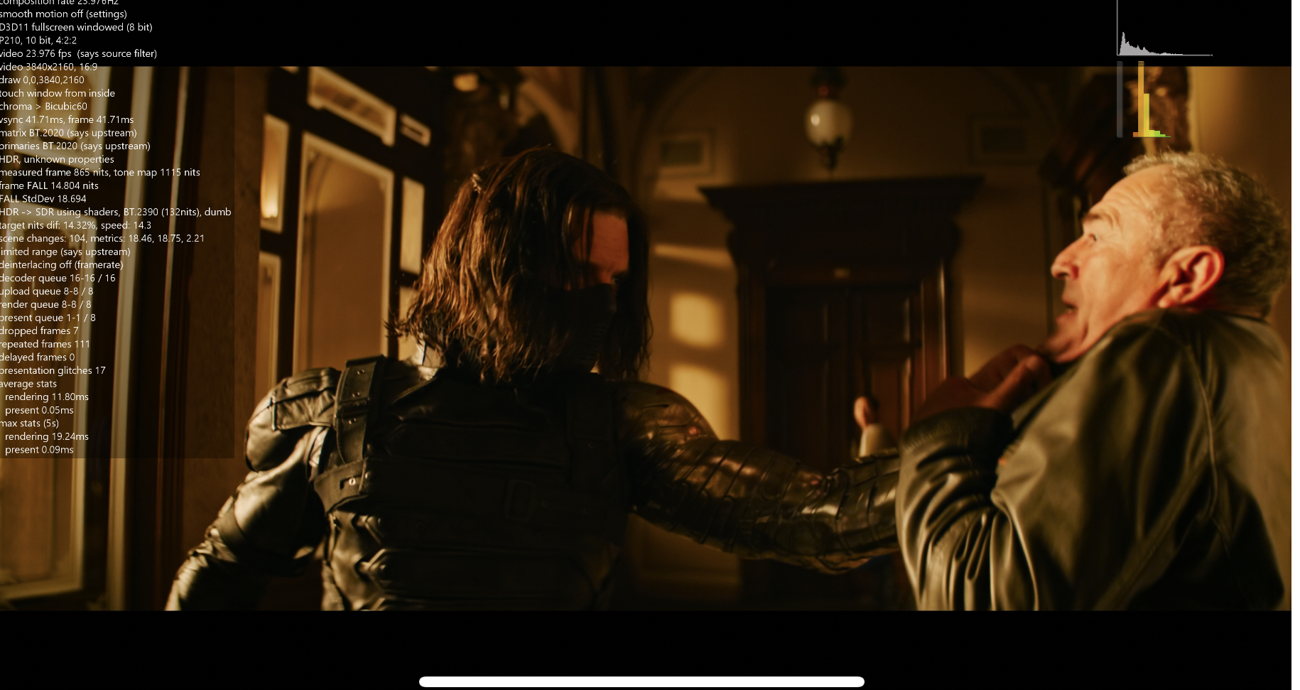

I'm not able to trigger DV with mkv container on plex/ugoos... is there a special build that I need to sideload like Kodi?
I'm also getting 2.0 audio only...
For fun, I checked LLDV vs TV-LED and they both look pretty much the same to me(no big difference as Vincent showed on the oppo). I only checked one movie, one scene, so maybe the difference is not the same from one movie to another ?

Interesting..RESET_9999 wrote: ↑Sat Mar 20, 2021 12:11 amI'm not able to trigger DV with mkv container on plex/ugoos... is there a special build that I need to sideload like Kodi?
https://screenshotcomparison.com/comparison/12104
If you check the CPU usage between TV led and player led is there much difference?
Check "Eagle" scene from SM UHD HDR Benchmark (around 6:34 time mark)RESET_9999 wrote: ↑Sat Mar 20, 2021 12:11 amFor fun, I checked LLDV vs TV-LED and they both look pretty much the same to me(no big difference as Vincent showed on the oppo). I only checked one movie, one scene, so maybe the difference is not the same from one movie to another ?
Pay attention to beak color
