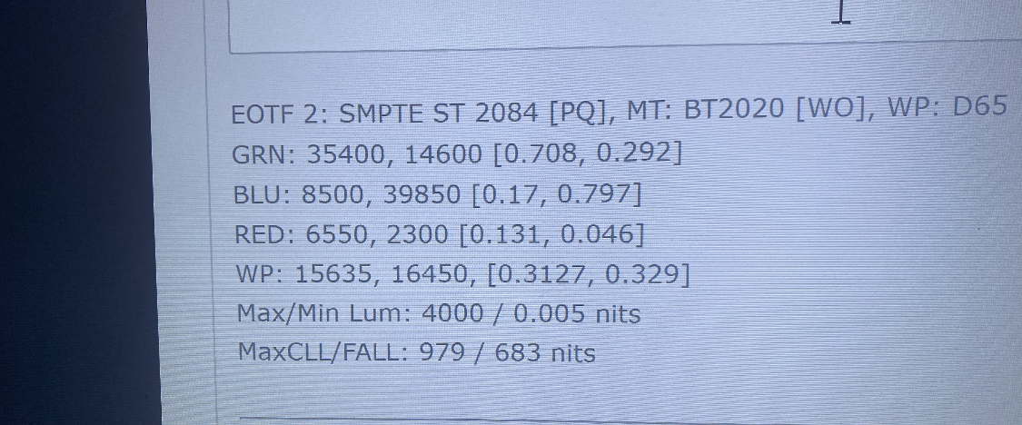

#4756 Post by Manixx2020beyound » Thu Mar 18, 2021 2:20 pm
No it wasn’t graded darker that is my test file png @1000 nit
Not sure where that meta came from lol

#4757 Post by RESET_9999 » Thu Mar 18, 2021 2:23 pm
Manixx2020beyound wrote: Thu Mar 18, 2021 2:20 pm No it wasn’t graded darker that is my test file @1000 nit
mmm, so you are getting different metadata from the HBO stream...
very strange, the metadata i posted is from the WEB-DL

quietvoid
Posts: 377
#4760 Post by quietvoid » Thu Mar 18, 2021 3:42 pm
The Dolby Vision RPU also contains the same ST2086 HDR10 metadata inside.
So where is the 4000 from :?:
#4761 Post by RESET_9999 » Thu Mar 18, 2021 3:56 pm
quietvoid wrote: Thu Mar 18, 2021 3:42 pm The Dolby Vision RPU also contains the same ST2086 HDR10 metadata inside.
yep that's right, when I turn off DV on my x700 and play a profile 5 file, I get HDR10 playback with the metadata from the RPU which corresponds to the HDR10 counterpart. I will try justice league on my x700 tonight.
The metadata posted by manix are the one from the HDR10 stream on HBO..
it's not a DV to HDR10 conversion.
maybe the web-dl are fake ? notice how the HDR10 version is encoded with wrong Chroma subsampling type 1 instead of type 2
you cant really fake a DV release though... maybe other streaming platforms? this is a mystery

#4763 Post by Manixx2020beyound » Thu Mar 18, 2021 4:45 pm
RESET_9999 wrote: Thu Mar 18, 2021 3:56 pm
Right now in hdr mode it plays in funky colors bt2020
Yes web dl meta was correct just triple checked after getting hdr version.
Last edited by Manixx2020beyound on Thu Mar 18, 2021 4:52 pm, edited 1 time in total.
