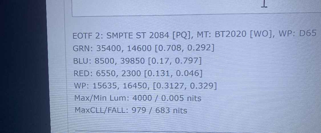

Post by Manixx2020beyound »
No it wasn’t graded darker that is my test file png @1000 nit
Not sure where that meta came from lol
Last edited by Manixx2020beyound on Thu Mar 18, 2021 3:29 pm, edited 1 time in total.
Manixx2020beyound wrote: Thu Mar 18, 2021 2:20 pm No it wasn’t graded darker that is my test file @1000 nit
mmm, so you are getting different metadata from the HBO stream...
very strange, the metadata i posted is from the WEB-DL

quietvoid
Posts: 377
Post by quietvoid »
The Dolby Vision RPU also contains the same ST2086 HDR10 metadata inside.
So where is the 4000 from :?:
quietvoid wrote: Thu Mar 18, 2021 3:42 pm The Dolby Vision RPU also contains the same ST2086 HDR10 metadata inside.
yep that's right, when I turn off DV on my x700 and play a profile 5 file, I get HDR10 playback with the metadata from the RPU which corresponds to the HDR10 counterpart. I will try justice league on my x700 tonight.
The metadata posted by manix are the one from the HDR10 stream on HBO..
it's not a DV to HDR10 conversion.
maybe the web-dl are fake ? notice how the HDR10 version is encoded with wrong Chroma subsampling type 1 instead of type 2
you cant really fake a DV release though... maybe other streaming platforms? this is a mystery
